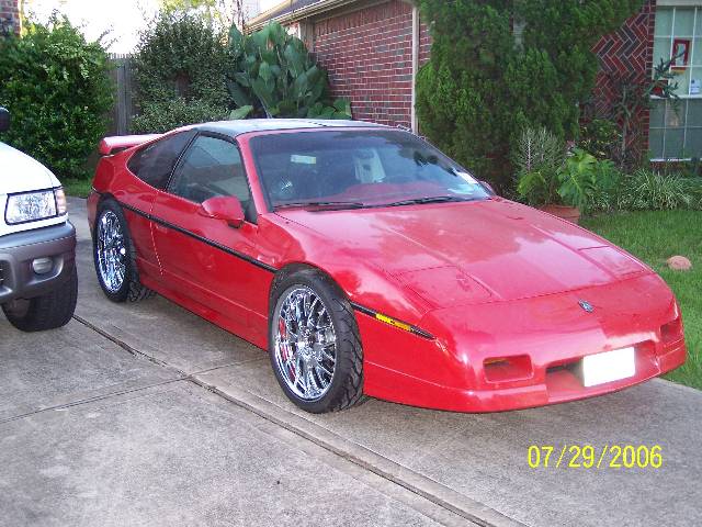

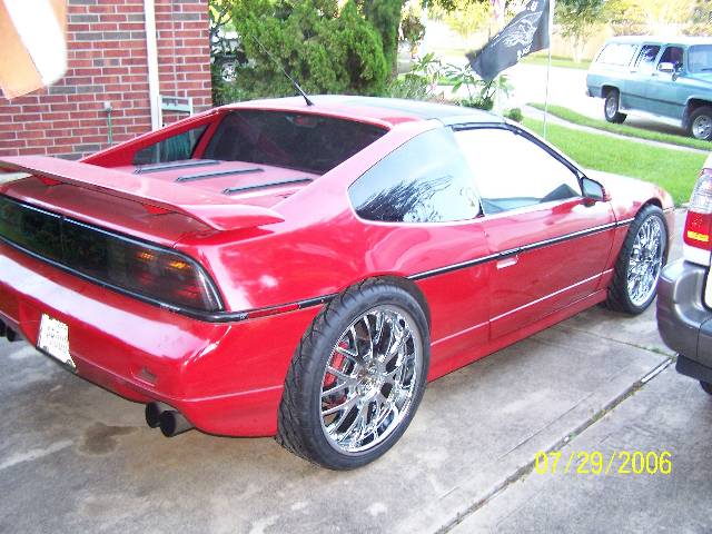

You can go 19/20 on a bone stock 88GT
fronts are 19 x 8 with 235/35-19 35 mm offset
rears are 20 x 8.5 with 265/35-20 35 mm offset
I would have preferred a front wheel with more offset or narrower, but they are not commonly available with matching rears.
