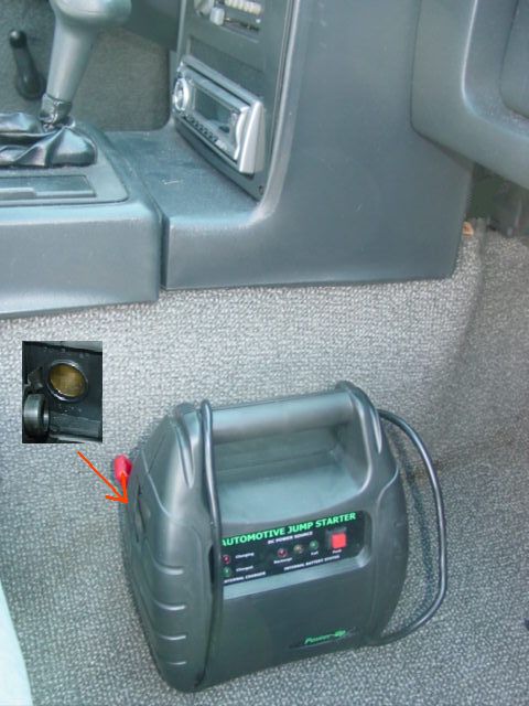

Might be easier to get one of these.
Just plug in the cord to the lighter. Got this for under 20 bucks.
