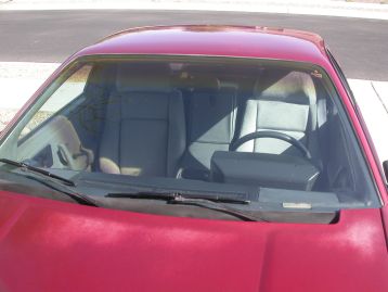

I have a 87 Coupe and the paint is good however It has some Clear Coat hazing.
Could anything be done short of an entire paint job?
Could just that area be Clear Coated?
Here is the worst of it.
Thanks
Hager

Yes, the area that the clear coat is hazing on can be sanded down, and reshot with clear coat, but you'll have to do the entire panel. As I understand it, you can't feather in clear coat like you can with the color coat....the whole panel will need to be sanded and shot with clear.

Here's a little out of focus shot of the bad clear cast area.
Where there isn't any clear cast it is smooth, and where the clear cast is OK it's smooth. However the transisition area between the two is very rough and kind of loose. If it use say a 600 grit paper can I get rid of that rough transition area, or will the clear coat continue to flake off without sanding smooth? And thoughts or experience in this.
Thanks
wrong, you can re clear just a section, and then buff the trasition from old clear to the new clear and make it match pretty well. but if your old clear is deteriorated or dull then it wont match and would need the whole panel re sprayed. but it is always best to do the entire panel. and you wont be able to buy a partal clear kit anyway and $170 will buy you a gallon of transtar euro quikclear (what our shop uses) and that is enough to do a entire car so you would have enough to repaint many parts if you wanted. if your clear is bad in that spot then it wont be long before the roof and deck lid start bleading through as well. so it would be best to respray the entire car if you can afford to.
85 GT, bright blue met. fastback, 18"s, 91' 350 SBC / Muncie 4spd
Thanks
600 grit on a block is a good chioce for the process, be sure the panel and paper are wet as you sand, and listen for any scratching noises as you sand and re soak your block if noise starts as that is dirt scratching your finish and possibly going though to sealer. change your paper often as well. it would be best to mix up a pint of base color as you will likly go though to the black sealer underneath. and will need to rebase that section. make sure when you mask the area to spray that you bend the tape back to form a round edge rather then having the tape flat. that why you wont have a enge of clear to sand. then once you have respayed the area and your ready to blend and buff start with a 1500-2000 grit and wet sand the edge and any inperfections. then use a buffer with a clean pad and good 3m rubbing compound and buff till the entire hood matches.

I take it this is mostly on the hood. Id just take it off, sand all the clear off with 400 grit dry (Firefox uses 360 I believe). Then a coat of primer, whatever kind you prefer. I use laquer Primer Surfacer myself. Resand with 400 and put on enough basecoat to cover evenly, followed by urathane clear following the manufacturers recommendation from the product sheet. A few bugs or bits of dirt is no big deal as you can wetsand them all perfectly smooth with 1000-1500 paper after its dry followed by buffing with rubbing compound. Not very expensive fix if you do it yourself. Some sandpaper, a little primer (get some from a shop, maybe even for free), pint of base and a pint of clear with hardener prob wouldnt cost you $150 total. Even a novice can do a pretty professional looking job if you take your time. An all over GOOD job can run anywhere from $1,000-3,500 these days.(hey gas is $3.00 . Do your spraying in the morning if possible since bugs are minimal and its usually cooler. Dont do it at nite, bugs will go to it like flypaper. Cover stuff you dont want painted and wear a mask.
Whuffo
Posts: 3000
From: San Jose, CA
Total ratings: 155
Report this Post06-21-2006 06:58 PM Click Here to See the Profile for WhuffoClick Here to visit Whuffo's HomePageSend a Private Message to WhuffoDirect Link to This Post
Back in the '80s GM was "having some quality problems" with paint; there's been many, many improvements in paint chemistry since then. Fieros were the least affected by the GM paint problems - those of us that have been around awhile remember the GM cars and trucks with big rusty spots all over them. The clear would lose it's bond to the base and flake off, then water would penetrate the base and make a big rusty mess.
Our plastic cars don't rust, so we just have the clear coat delamination problem to deal with.
For those who want to just sand off the old clear and put a fresh coat of clear over the old base - yes, it's possible but you will NOT be happy with the results. The bond between the new clear and old base will be largely theoretical; it'll start coming off almost immediately. Ultimately, this only makes a bigger mess than you started with.
A workable repair method has already been explained: reshoot base and clear on entire panels. If you just do the panels that face the sun you can get a few more years before the rest of the old paint fails; if you're only going to keep the car a year or two this may be your best option.
If you want it to look right and last - the only real answer is to repaint the entire car. Yes, it can be expensive. But here's something to think about: it'll cost even more if your painter has to deal with peeling patch jobs.
