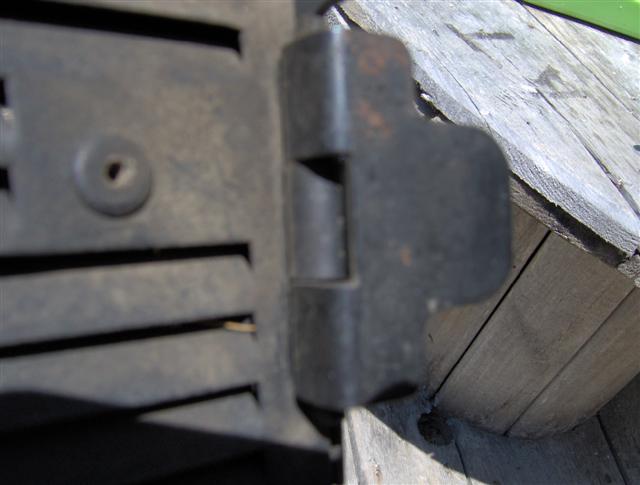

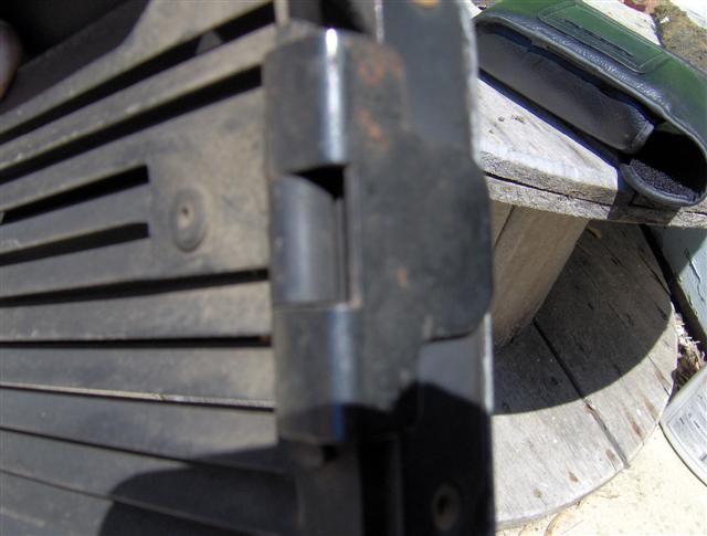

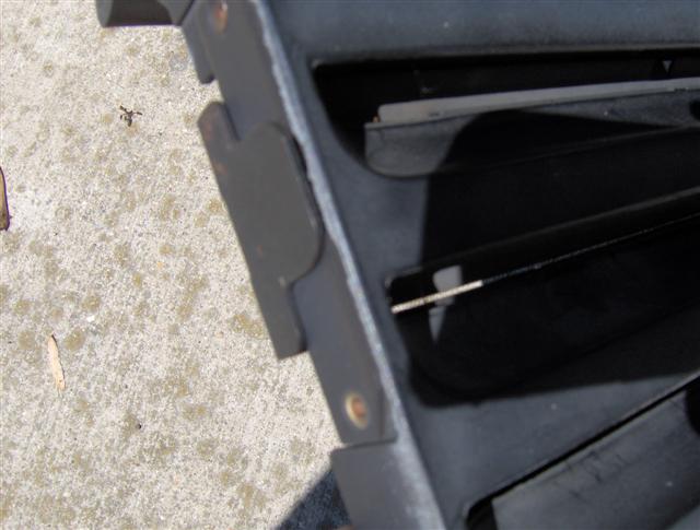

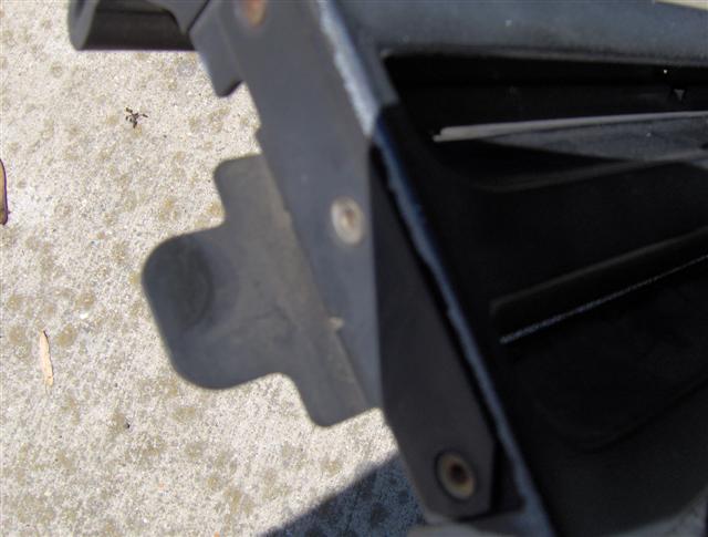

I have looked a alot of vents on GTs and nobody has a set like mine. How rare are they?
If you can't figure it out from the photos - the flap flods up and down.
It's the small flap that is on the inside back - where the trunk lid closes on it.

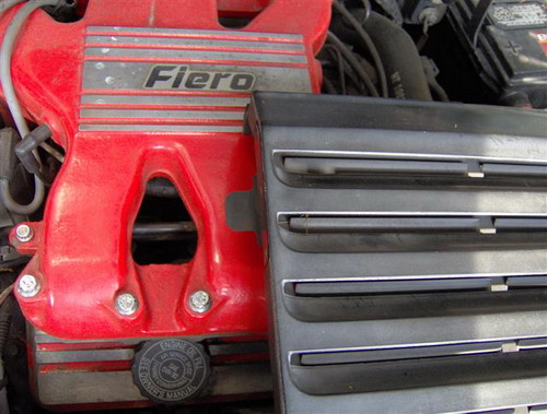

can you take an overall shot of them?

ARKaiser
Posts: 1305
From: lansing,michigan,usa
Total ratings: 62
Report this Post06-15-2006 07:12 PM Click Here to See the Profile for ARKaiserSend a Private Message to ARKaiserDirect Link to This Post
California Kid
Posts: 9541
Total ratings: 274
Report this Post06-15-2006 07:42 PM Click Here to See the Profile for California KidSend a Private Message to California KidDirect Link to This Post
That tab is to put a load on that corner of the grill, so that it doesn't vibrate. The newer grills have a metal "L" bracket with small rubber bumper pop rivited at that location, for the same reason.
