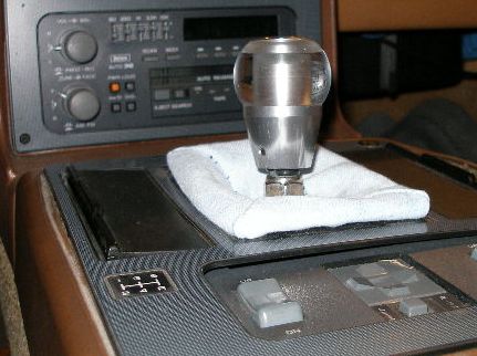

Short shifter
The stamped steel that holds the stock shifter was sawed off, and 2 nuts were welded onto the steel bracket for a 1/2-inch bolt, this is so that I can adjust the length easily. I have driven with it for a while, with the stock shift boot, But I have shortened the length approximately 1.5 inches to the height that you see in the below picture, and have made a temporary boot out of denim to test.

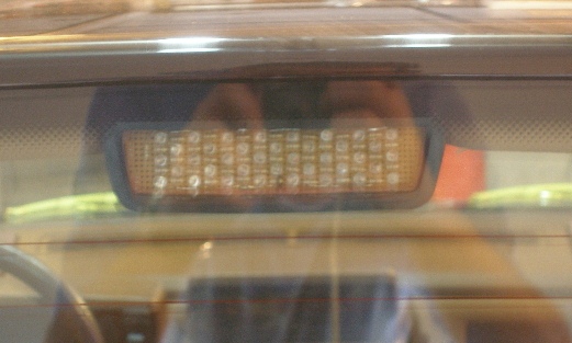

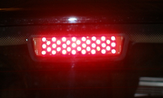

The third brake light was replaced with led's, in the light picture they appear white, but that is just because I could not get a good picture. The lights are brilliant red, and brightest from directly behind, but are still bright from the side.

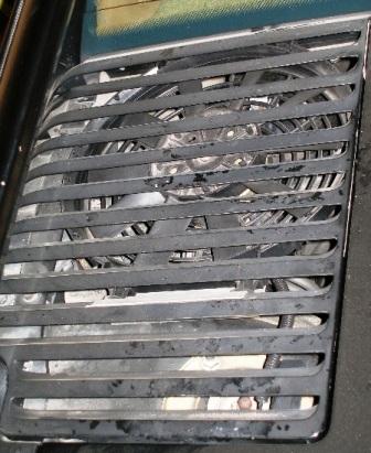

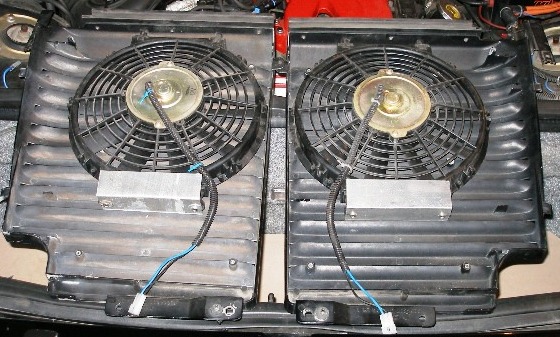

Also I put two 1000 cfm fans in my engine bay to help keep the electronics cool, which come off with the grills, pictured below.
They push a great deal of hot air out of the engine bay when running, which feels like most blows right under the spoiler.

I LIKE that fan idea to vent the engine compartment !!!!
Think I'm going to steal it from you. What are those, VW rad fans?

They are 2 10" pro-form radiator fans. I ground off the studs to get the fans to go flush against the bottom of the grills on both sides(not required, but gives an extra 1/8", required if bottom screen is removed) as well as lowering the fuel vapour can to get the clearance required on the drivers side. You may also have to cut 1/4" off of the plastic wings on the air cleaner wingnut, I just replaced mine with a easier to remove nut. There is lots of clearance on the passanger side above the battery.
Hope this helps.
edit to add:
Make sure you get a push pull reversable fan if mounted like in the picture, as you want the air to blow out like the hot air naturally wants to go. Spal also sells similar fans, look up any race shops nearby, they should have them in stock.
