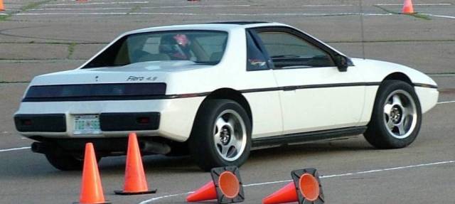

I am surprised that more autocrossers or road racers haven't chimed in. But, just for info, every autocross driving school I have been to has had a 200' skid pad so that the student could learn the lateral limits of his car (and sometimes of his/her limits, also). Most regions have at least one driving school each season - - check with your local club!
My little white 2600lb street Cadero is also a daily driver like California Kid's car (but not as pretty). Anybody at Wheatstock saw what it could do - especially on that tight postage stamp size area we were given to hold the autocross. The only car to beat it was Team Python in their race-prepped 2200lb car - - and had my son had a clean run, Tom wouldn't have come close! Road Runner, in his tube framed monster would have eaten it up on a more open course, but as tight as this course was he couldn't get any momentum going.
Of course, I have a lot more $ in the suspension than I do in the powertrain, and it took several years to get it dialed in after it was built. But like Cali Kid, I also can exceed 1.1G in my street Fiero. As a side note, it runs in the family - - My son won a skidpad contest at Topeka in his Street Prepared '84 Camaro at 1.14G's (check out the 5 page article in Road and Track, Feb 1999)
Anyway, when you turn both ways as fast as you can go, even while left foot braking and accellerating at the same time - - there is no sensation like it. Just ask those that participated in the track days at the 20th or Wheatstock, or the autocross in Topeka. Going straight under acceleration (positive G's) for 12 - 15 seconds is not nearly as adrenaline generating as accellerating, braking, drifting and turning for 60 - 150 seconds on a road course, or especially the constant adrenaline for a minute or so in an autocross. The body experiences positive, negative, AND lateral G's out there - - sometimes two G forces at the same time, or even all three within a fraction of a second - nothing like it!!
G
[This message has been edited by cadero2dmax (edited 01-16-2006).]

cadero2dmax
Posts: 1266
From: Brighton, CO
Total ratings: 60
Report this Post01-16-2006 12:26 PM Click Here to See the Profile for cadero2dmaxSend a Private Message to cadero2dmaxDirect Link to This Post
Originally posted by 3.8T:
^ Amen brutha.
I was thinking the same thing.....and its quite true what u speak of in terms of handling limits and the forces u feel when doing road/auto-X....nothing like it. i find myself even 'tired' and breathign quite heavy after a serious run of either lol. espeically since our cars take just that much more skill/coordination to drive over a fwd car.
im actually having a nice back and forth jab-fest with a buddy who drives an 04 WRX STi and have to hear it from him how "his car outhandles" everything on the road...blahblahblah, and of coruse AWD. fine i KNOW the car is wicked in that regard, but i tell him to come on up vs. a done up fiero (motor AND suspension) and we'll do a "G" test
My Cadero is an '85SE with a slightly warmed 4.9 and Isuzu 5 speed. That engine is definitely a torque motor, with peak torque at almost off-idle. It is RPM limited, but the power and torque curves make that engine/tranny combo almost perfect for ax'ing - 2nd gear could be a bit taller, but - -
The supsension? Front is a modified stock suspension with improved dynamics, Koni orange shocks, a 1 1/8" swaybar, and 325lb springs (that retain stock ride height). I DO run the shimmy damper, even while on course, BTW.
The rear suspension is a modified '88 cradle with a raised roll center, utilizing coil-over shocks with 8" 400lb springs. The swaybar is a stock '88 rear. The tires I currently use are 10" wide Yokohama slicks (actually, they are take-offs from Pro-Mazda formula cars) on 15x9 wheels.
Using timing equipment from the SCCA NeOkla region a few years ago, the Cadero registered 1.12 G's on a 200' skidpad set up at Davis Field in Muskogee (a very grippy concrete surface we used to utilize for local and Divisional events). That was with BFG R-1's and not the slicks - - I would think the slicks would do better.
Anyway, there are quite a few Fiero autocrossers that your buddy wouldn't want to run up on. But that isn't quite fair, his is a stock machine with stock suspension and stock motor - while all of ours are modified. His Subaru might have an advanced AWD, but his power doesn't come on until after a terrible amount of turbo lag. His horsepower and torque peak at awkwardly high RPMs. Not conducive to autocrossing, but hellish in a rally!!
G
