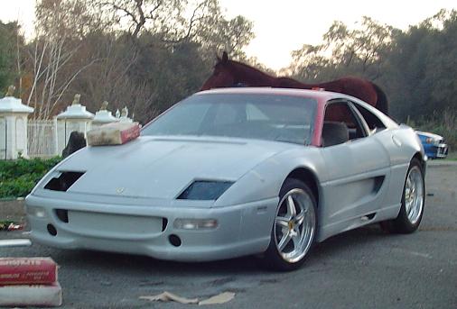

This is kinda a old picture of my car but you can see the factory Ferrari 355 roof line, my car is built on an 86 Fiero GT. I would have to say unless you really want to spend some good money on a good kit, stay away. I have the best 355 kit on the market and it is still a big pain in the butt to put together. I have seen too many good fieros get torn apart and never finished because the kit sucked. If you have the time and are good with fabrication, then go ahead and start a kit, but take my advise and buy a good kit up front. If I can help you in anyway feel free to ask. Oh and by the way these arent cheap to build, im already in over $14,000.

Just a picture of the front.

Where did you get your kit? and how much did it cost? The doors look much better than 98%of the kits you see. Thanks, Mark Klein

Chris, if I'm not mistaken, is doing the AD355 by Air Dynamics. Best 355 available, period.
Doni: You have to go to Ari's kitcar Forum: www.kitcar.ca There are a lot of builds there, and good people that can help. In the tech forum, there is a post on converting the convertible to the Berlinetta, not using GT parts. I forgot who's doing it, but they formed the back section out of foam, then fiberglassed over it. And, as mentioned above, 355Spider used the AD355 convertible and the Fiero GT fastback to form a psuedo 355. It looks pretty good.

RCR is right it is an AD 355 (Air Dynamics), It cost $7,500.00. AD kit is nice because it can use all original Ferrari parts, for example my car has factory: Challenge Rear Grill, Tail Lights, Third Brake Light, Emblems, Quarter Windows, Turn Singles, Front Grill, Muffler, and much much more. The nice thing is all these part just bolt up to the AD kit without modification.
