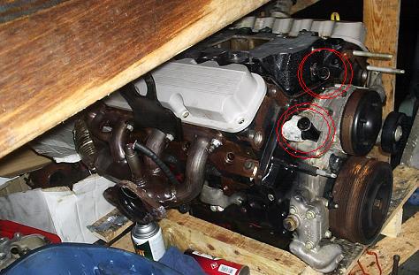

Lets try this again with the pics and pip, The 2 things circled I have no idea how I will hook these up, The bracket that I took off connected them, And Im getting a low mount alt bracket made by loyde, And I think that part will probally be eleminated. I think if you simply run a hose to it it will easily pop out the intake part ( That piece of plastic is not in there tight)
Yay it works My work area is a pig pin LOL, I don't think that oil filter housing is going to work LOL, I also need to get ahold of a GTP idler bracket, The one that came on the engine looks like it will hit the firewall. This engine came out of a 1999 buick park av Ultra, Not a regal. The only thing that I have done since I got this engine is take the manifold off and paint it black, I was screwing around testing the hi temp gloss black paint and got the timming cover a bit and the oil filter housing LOL (comming off anyway to be polished) I kind of want to take the heads off to polish the exhaust ports and ect.

Earl,that plastic elbow will be replaced by a freeze plug of that size that Loyd can provide you and the black heater hose connector will go with that aluminum assembly that goes in the water pump,that has to be removed for the low mount alternater.Then you have to tap that hole and fabricate and plumb that for your heater hose.I'll hold on to that supercharger until you let me know,it's from my engine that came from a 97 GTP.If you take the heads off you will need new head bolts as those are torque specific and can only be used once.Good luck,you'll love it once it's done.

Here in a pic of my engine you can see that WHOLE tensioner assembly/coolant tube piece is removed. There is an elbow tapped into the waterpump housing and a pipe barb over that which conencts to the coolant tube. Then i installed a freeze plug into the lower intake manifold hole.
Hope that helps some!!

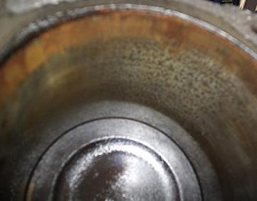

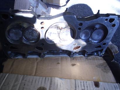

A little update on the engine, This weekend I had to pull the heads anyway. I was rotating the engine and everything was fine till it locks up, I rotated it the other way and it locked up, Pulled the heads and found a huge washer like deal inside one of hte cyls holes, It was about the size of a nickel and was 1/4 thick. That was the reason why it kept jamming at a certain point, Needless to say im glad I did pull the heads after all.
Somehow that bugger got down inside it (probally skide between a valve when I was rotating it or when they removed it from the car)
Every cyl was very nice and clean except one The engine sat for 3years. It has light rust specks on the wall of this cyl, It probally will be fine if I leave it like that, But im going to take it to a machine shop and get all the cyls honed and rering with some new piston rings.
Im going to get new vavles for the heads, But the heads looked very good when I pulled.
Here's a pic of the nasty cyl, Any Thoughts or ideas ?
