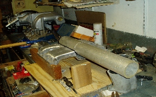

humm 50 mm canon

Not to rain on your parade, but your idea probably won't clear the distributor, and won't make much difference power-wise. It removes the restriction at the neck, but the rest of the stock intake is still restrictive. You'll increase the plenum volume, which is good for torque, but the 2.8 already makes about as much torque as its going to in stock form, so this probably won't do much. Looks cool, though.

Looks sorta like the WCF one, but it has to bend to miss other components...

it will bend the clear the dist but i haven cut it yet
am trying to figure out how long i need it
the piece of wood on the left is where the stock
throttle body sits
