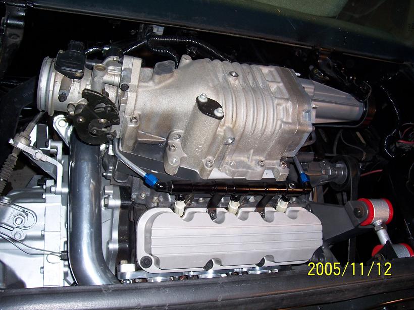

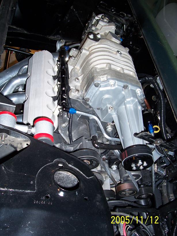

Well, this project was not 10 days to install. Put a little more into this one. I am sure Will will expand on this car as more items are done to it. Code name is "BlackHeart" . I think it should be "DarkHole" . I had to add some pieces with silver, red, and blue just to make sure the engine showed up in the pictures.
I will post more on this in the next few days. I still lack starting it, but it is ready at this point...
Specs on this project...
Black paint everywhere...
88 Formula
3800SC engine with ZZP Stage 2 InterCooler
5 Speed GETRAG
TOG Extreme 1.75 exhaust
ZZP Black Rails
CAI
Custom wiring
Custom fuel lines
Custom Intercooler plumbing
KYB coil overs
Dropped front springs
Poly everywhere
BIG tires and wheels. Wait till you see these things on the car.
and the list is longer...
Enjoy !
Loyde

Let me be the first to call "Teaser" on this. MORE PICS!!!
looking great so far.

I like it! Only thing I'd do different is paint the supercharger, very sexy motor when done up.
I would like to tackle a 3800sc after I finish the N*.

I like it! Very clean and professional. I plan to go blackout too.
Yes, the SC is stock.. I see a Stage 4 upgrade in Will's future. I will get it power coated something to match the rest of the scheme..

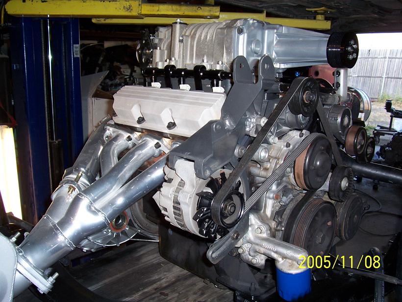

Is this "Will" on the forum... with the northstar as well? Or is it some other guy named will?
Looking good! Do you have any pictures of the trunk where those headers come out? I'd be curious as I've considered trying something like that myself.

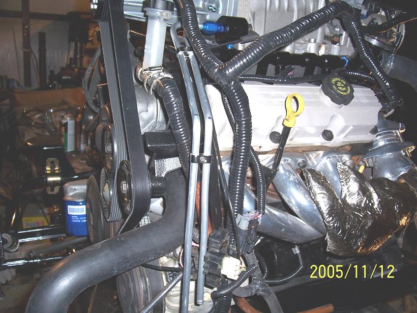

Looking good and I bet Will is ready to get his car back as you are ready to be done with it. I like the hardline for the fuel lines, differant but clean, even better looking that the braided steel lines. Thats one last thing I have to get for my new motor is fuel lines, need to hurry and stop putting it off.

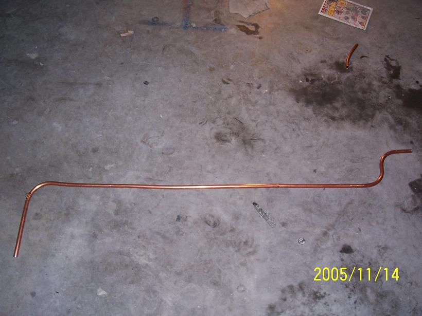

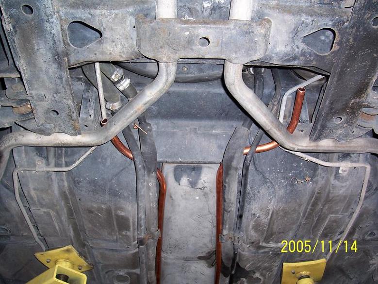

Right tool for the right job gives nice results... I recently purchased a Rigid ratcheting tube bender for 5/8 line.. Made these nice Intercooler exchange lines..
With my new method of doing the hardlines up top on the IC stuff, it really cleaned up the bottom area. This is complete except for AC lines installed.
Loyde

Wondering how come you chose not to use the returnless system on this car as you did the last??
Does this mean the start of an Auto build???
Since the returnless requires a bit more plumbing, Wills install was targeted to tight and clean lines for show status. Plus, I am always trying something new to get that feel if I want to offer it some more. I had to buy alot of benders and more fittings to get all the stuff needed to get were I like HardLine used. Hardline is nice and tight looking when properly bent and placed.
Auto is coming next .. I know what you want.
