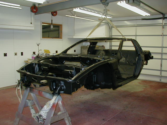

Not sure if I'm following you, but the roof (windshield pillars and roof section) will come off of the frame. As already mentioned, the Fiero frame is a one piece unit. It looks like this with the body and mechanicals removed (not my pic):

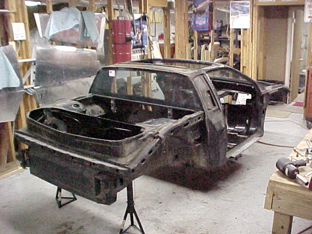

Here's a pic of a totally (except for the rear window) disassembled Fiero to give you an idea of what would be left.

Ah, sweet. Exactly what I was looking for! Thank you all. Really big +'s handed out to all of you!
