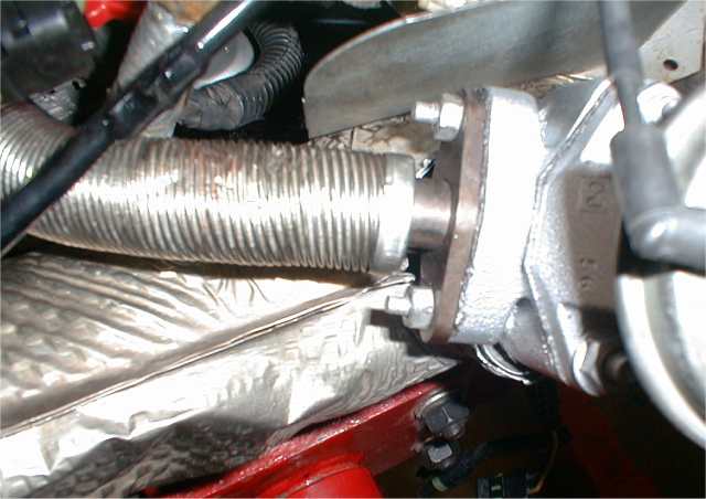

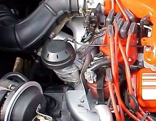

This picture shows the EGR cover (w/ a black cover)
This is a plain egr tube.
This picture shows the tube connectted to the EGR adapter

Thanks 200RT, that's great and I did manage to find the EGR and confitrm that the plate inside it does move up and down but the engine runs the same when I do this, is that normal?
