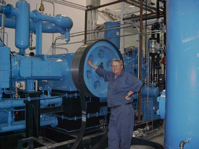

5hp = around 3 true hp ...Time For An Upgrade
Not To Long Ago I Worked On A 800 Hp Unit ...Of Course It Was The Size Of A Train ..But Hey
And No Thats Not Me Above lol
