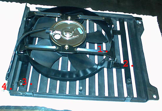

I like the setup Tina has in this post. I will probably just run one off the fan that is already in the trunk.
https://www.fiero.nl/forum/Archives/Archive-000002/HTML/20040223-1-034799.html
yeah i've been thingking about that due to the added heat of a turbo

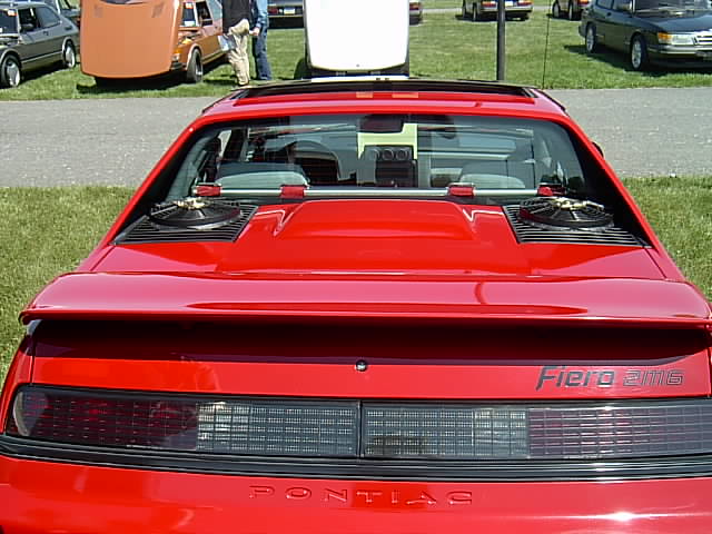

darn and I just put mine in the stang scoop
What are those a punch of 80mm Case fans. I like the idea, hmm, blue or red LED case fans in seris. Hmm.
derangedsheep
Posts: 3089
From: Myerstown, PA
Total ratings: 114
Report this Post07-01-2005 01:53 PM Click Here to See the Profile for derangedsheepSend a Private Message to derangedsheepDirect Link to This Post
I think that would be cool if you could get the outer most fan to flash its LEDs with your turn signals. I dont know much about LED fans though. Are the LEDs on whenever the fan is turning or can you turn the lights on or off?

The leds in the computer case fans are hard wired to the power source, so you could modify it if you wanted, but it'd take a ton of work. Also - it'd look goofy :/

i'd tend to think that they would cook - not designed for that high of temps

Computer case fans can run 25,000 hrs @ 100F I am pretty sure they can handle a fair bit more heat than you give them credit for. I might try an experiement feed a fan 300F temps and see what it does. I wonder how hot a heat gun will get.

The housings and blades on most computer fans are made of ABS plastic. ABS can only handle temperatures around 150F degrees before it starts to soften and deform. It will start melting around 200F degrees.

Revin's had his there for a while now, it doesn't look warped.

Nope never a problem with heat.
Yes just simlpe case fans. With a wing, you can barely see them inside the scoop.

Arns85GT
Posts: 11159
From: London, Ontario, Canada
Total ratings: 202
Report this Post07-02-2005 12:59 PM Click Here to See the Profile for Arns85GTSend a Private Message to Arns85GTDirect Link to This Post
Revin helped me out. I bought, at the surplus electronics store, 8 brushless computer fans, 12v, .15 amps.
I took them out of their mounting brackets and mounted 7 of them across my six pack scoop holes. They are controlled by a two channel Derale fan control unit. The fans cost $2 a piece and the Derale system about $65. I can dial in my fan switch to anywhere between 150* and 250*.
So far it works pretty well.
Arn
Wire them in parallel, not series.
Arns85GT
Posts: 11159
Total ratings: 202
Report this Post07-02-2005 08:00 PM Click Here to See the Profile for Arns85GTSend a Private Message to Arns85GTDirect Link to This Post
Arn
Well, it works well at street speeds, but not on the highway. I did some research today. It is posted in the technical forum. I may be going to some more serious fans.
https://www.fiero.nl/forum/Forum2/HTML/064636.html
Arn

Report this Post07-03-2005 02:06 AM Click Here to See the Profile for TinaSend a Private Message to TinaDirect Link to This Post
Ahhh, the curse of the rising temp in the engine bay.
Not bad if you are moving, but at slow speeds, higher rpm ...
Bring on the eggs and bacon, we are doing are own "To go" while we are not going anywhere in traffic.
I added mine about 2 years ago, passenger side grill.
(Seemed the better choice, considering the lack of space in the area)
What you will need to do this is, is the fan. Part # PRM 19010
For about 5 bucks more, it seemed like a bargain
( 400 cfm more than the Summit fan and it is reverseable)
1. I mounted mine with fan mounts facing the interior of the engine bay.
Just a little added insurance to keep things out off harm/fan blade's way.
2. Also you will need some small strips of metal to be able to mount the fan housing to the back side of the grill.
3. Mine are welded to the housing and then screwed into the grill.
4. The fan itself itself was wired in such way, that even with the ignition off the fan still has power .
Ended up using a adjustable thermal switch, I get the beni''s of the thermal control as well as a manual override.
Part # rpm 19001 for the wiring kit, 18905 for the adjustable sensor or 18907 for the adjustable thermal switch.
Now here comes the disclaimer ... if your engine is running too hot, this is not going to make the difference.
... if you went with the regular wireloom, it might still melt in places.
And ... I am not going to get in the middle of what is better. Having the fan blow the hot air out, or sucking cold air in.
Tina
