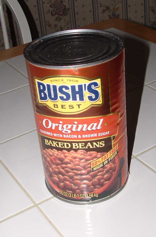

All right, my OEM coffee can has a rust hole in it. I looks like some kind of Juicy Juice can, 7" tall, 4 1/4" dia. I can't believe that Pontiac would put something this lame in the engine compartment. (no 2.5 jokes please) Have they no shame at all?
Before I go to the Piggly Wiggly and start measuring the Prune Juice containers, has somebody found a good (better) looking substitute? (like an empty fire extinguisher can)
Ideas please!

Coffee can. Just like you said. Worked fine for me. I prefer Folgers, but even a store brand/generic can will probably work. It just won't taste as good.

Ehhh...BigRed, I found it!
Perfect size & everything!
Do you think it will make the exhaust smell worse?
Should I leave the label on?

Well, I guess the whole forum knows what we're having for dinner tomorrow night!
I think the paint fumes have finally gotten to him.
That would be really neat if you left the label on! What a coversation starter. -Jason

Red thinks that I should Photoshop a label with the "Bananaman" on it.

so have you found the bush's baked beans secrect?

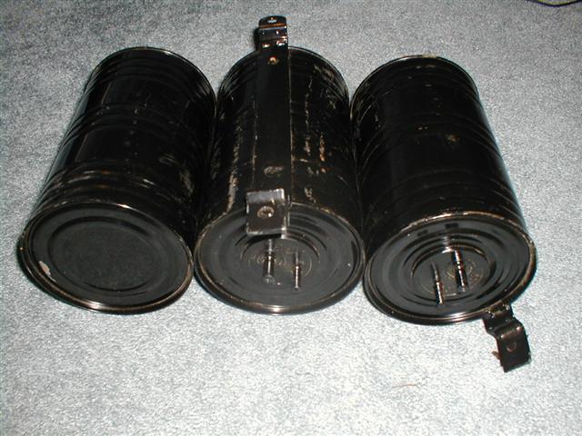

looks like it will work. I have a can off a ford F150 that looks identical riges and all it may be rusted threw but ill drop it off if you want it the bottom is excelnt.

this is off the f150

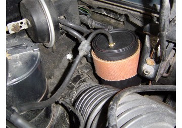

I moved my vacuum canister to the left rear well, behind the tire. Out of site and frees up some space (had to for the turbo).

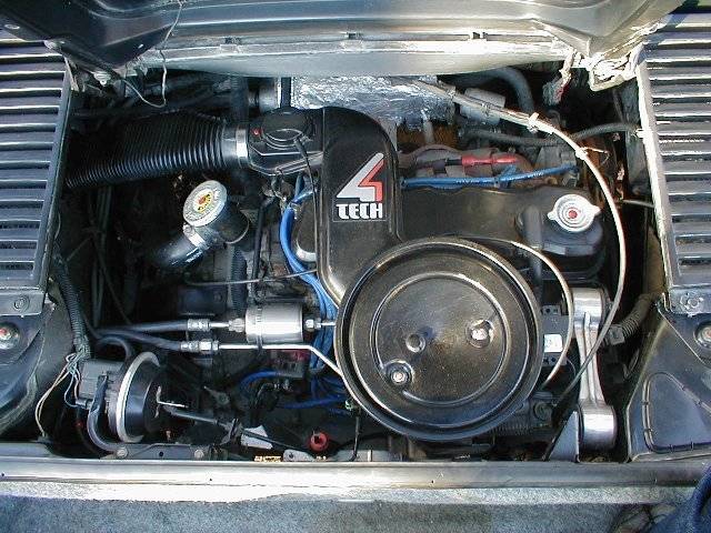

Great idea! I've been adding the cruise bits to my turbo car, and it's starting to get DAMN crowded over there!

Gordo, if you are going to use that bean can make sure you get a can opener that cuts the bead on the side. This will make it easier to reaseal the can after emptying it's contents. You can then braze it.
I figured that I could use a hole saw on the end and re-mount the plastic hardware from the original with epoxy. The main problem is coming up with a suitable label.
Very interesting.

i used that bean can. i think it was the 55oz but not sure. i cut the top off of the original can and rtv'd and riveted it to the new can. its held up for 3 years so far.

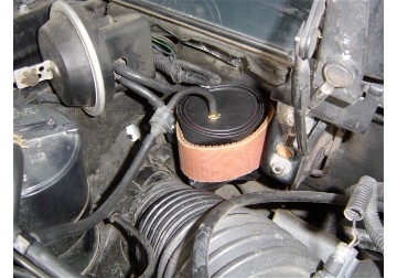

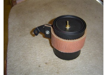

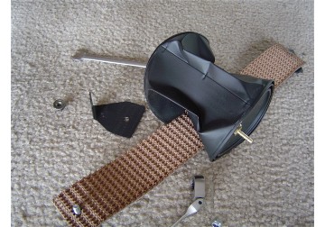

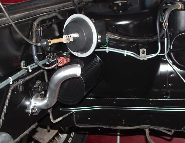

Here is how NOT to make a replacement cruise cannister...
Yup, just a standard paint can.
In my 3800SC swap, this was placed in a different position, as shown in this pic:
When I went for the first test drive, it didn't work! Then I noticed something...
Upon removing the cannister...
So, an apple juice can will work, but not a paint can!
Just thought you would get a chuckle out of this under-engineering.
...Rickker

Yeah, that's the problem. Most cans are designed for pressure, not vacuum. (except for food cans that is)

Any of the plastic ball type ones will work and you'll never have to worry about rust again. You can get them off more junk cars than you can count. You can get them new thru MotorMite. One about the size of a grapefruit will work with most cruise systems.
The cruise doesn't need a very big reserve.

Virtually all GMs used the exact same vacuum can. It's easy to find them in the wreckers - I am using one that 1/2 the stock length (same diameter). Many have also used the plastic round ones used on newer GMs without any problems.

Report this Post10-19-2005 06:30 PM Click Here to See the Profile for pauledudeSend a Private Message to pauledudeDirect Link to This Post
Like This?

Report this Post10-21-2005 08:32 PM Click Here to See the Profile for Max The ChainsawClick Here to visit Max The Chainsaw's HomePageSend a Private Message to Max The ChainsawDirect Link to This Post
Originally posted by pauledude:
Like This?
Yeah, that'll do it.

Gordo
Posts: 2981
From: East Guilford, NY, USA
Total ratings: 114
Report this Post10-21-2005 09:51 PM Click Here to See the Profile for GordoSend a Private Message to GordoDirect Link to This Post
Originally posted by 1MohrFiero:
So how did this turn out Gordo?
Wow, can't believe that this thread got resurrected!
I took the can & cut a large hole in the top using a hole saw and my drill press. It was not easy to do and I had to be careful because it left a very sharp edge. Next, I removed the plastic valves from the old can and fastened them to the new one in a bed of epoxy. So far, it looks pretty good and fits exactly like the oem can. I won’t be able to road test it until Spring.

Report this Post10-21-2005 10:26 PM Click Here to See the Profile for 30+mpgSend a Private Message to 30+mpgDirect Link to This Post
Put the can up under the left vent. Makes the distributor much more accessible.
