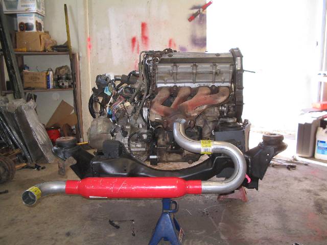

ShaddowGT can you post some pictures of yur exhaust? Would love to see your set up, Ill take some pictures of mine this weekend and post it here.

Here is mine, all I have added was a resonated tip:

Wow that must be very laud, Im suprised the cops dont keep pulling you over. You might try adding a Supertrapp to reduce the noise.

I might check into that, I do have a monza style resonated tip, the inside looks like the glasspack, it stops the snapping sound and gives it a deeper sound.

You could of put a small Catalytic before the first bend, thats what I did. I was just sick and tired of allways being pulled over by the cops and getting "exceeding noise" tickets....it was allways thrown out by the judge but still a pain in the arss.
