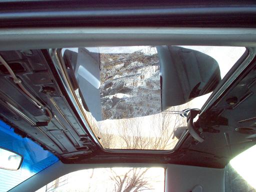

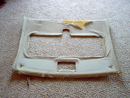

Well if you look at the pics of my headliner you will see why I am REDOING it.
The material was hanging down at the back near the back window and the color now looks soooooo faded.
I will be replacing the material with a similar color or I might end up going with black as that is the color of my dash and all that.
Headliner Before
Looking from inside up towards sun roof. Showing the missing headliner

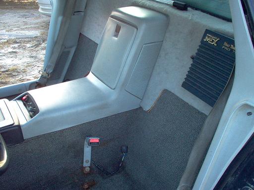

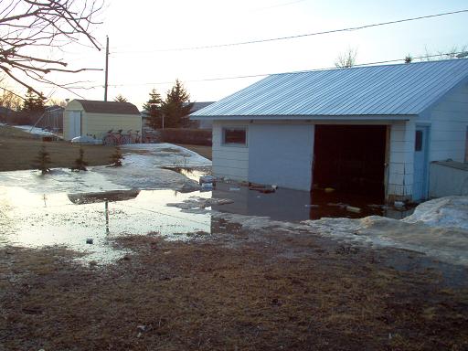

I don't know if Anybody followed my fiero's near Death by drowning thread but I had to take out my seats and have the car dry out and while doing that I noticed that I may as well remove the headliner.
My garage is still pretty much a large swimming pool
My car airing out
Pic of inside of car with no seats

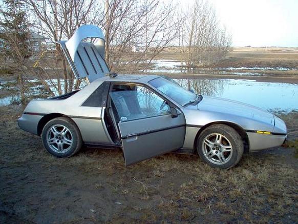

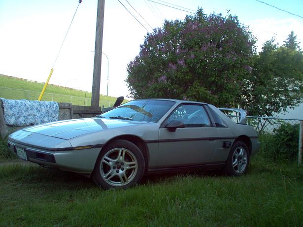

that is an interesting spoiler you got on there....any pics from other angles with the trunk down? (besides yer sig)

Oh yeah, pic of car with hatch down as requested

Headliner is done. I ended up rolling on the contact cement. The stuff I had would have been too thick to spray anyway. Since I ran out of contact cement, I used the 3M #90 (I called it super 90 above) to do the overlap behind the backer. The problem I had before was that I did not spray it on heavy enough. It does seem to hold well. The biggest thing I learned is to make sure there are no imperfections in the backer board. I strengthened mine up in a few places with resin, but didn't bother to smooth it out...Mistake...The new liner shows all the imperfections. I'm not particularly happy with the end result, but it is worlds better than what I had. Pics are still in the camera, so I'll edit this post when I get to download them...

I have a quick question...I started doing my haedliner last nite...I'm using JoAnn's Fabric headliner material and 3M super 90 glue. I sprayed the liner and the backing board, waited several minutes til it was tacky and placed the liner down on the board. It didn't stick for sh#$. Did I not use enough glue? Or should I scrap it in favor of DAP contact cement (I have some of the DAP gel)?
Bob
just did mine last week. used that super 90 stuff i think. came out like a spider web or something. yah, i read the directions, sprayed it on, waited, and it didnt stick. well, i tried it again, this time no wating. worked like a charm. the headliner stuff i used is a headliner/foam combo, not real thick, about the same thickness as a cd case. well, in any event, came out great when i didnt wait. oh, i thorughly sanded my headliner board before all of this too. thoroughly.

A small update on my headliner....My car was forced into service for a couple of weeks while I searched for a new car (my daily driver died). Well, after 3 days in the sun, the headliner fell. I haven't torn into it to discover why yet, but I glued the crap out of it using the DAP contact cement. I must have missed something in the preperation because I've never heard of the contact cement failing. The car has returned to it's spot in the garage, but it may be a while before I get back to it...
