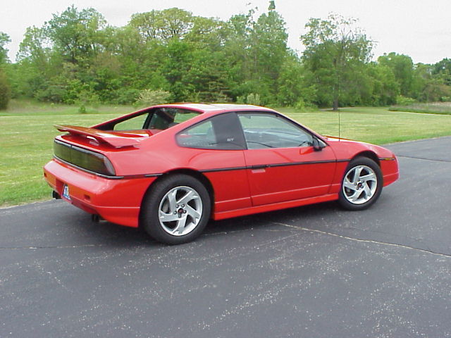

Here is my 88GT with the 16" Vibe wheels. The center hole did have to be machined to the 57.1mm GM/Fiero hub ring size. I only had the hole machined 15mm infrom the rear face of the wheel so that the stock Vibe center caps would still fit. The wheels would work great on a 84-87 but the offset (39mm) and wheel width (6.5") push the outside-edge of the front wheel out 8mm (3/8") and tuck the outside-edge of the rear wheels inboard 12mm (1/2"). I have just installed 8mm thick spacers on the rear of mine to get the rear closer to where it was with the stock wheels.

Turbotoad.....the guy Im referring to didnt have wheels like yours. His were flat-spoked 17" wheels. I guess the Vibe comes with more than a few different patterns and rim sizes......Oh, and he told me he simply used a Dremel to enlarge the center area.
You had yours machined?

I got 1991 16 inch grand am rims on my fiero.
