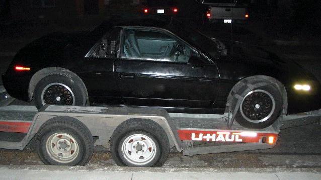

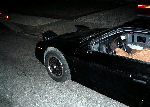

Using a standard UHaul car trailer and my Durango.. I hauled one a few hundred miles with no problems at all.
Drove it straight on and straight off.
The only thing you have to be carefull of is the fact that there is no winch. The doors will hit the fenders of the trailer and not give you a whole lot of room.
I had to crawl through the window to get in and out of the car with it on the trailer.

Dang it Jason you beat me to it lol . Yeah after Jason drove the Fiero up the trailer(remember no winch?) we realized......he had to crawl out kinda sucked lol.

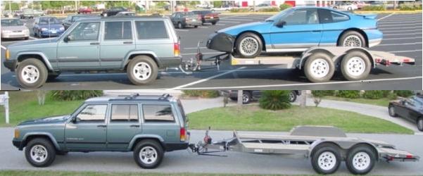

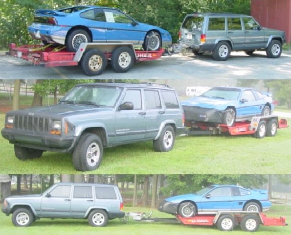

It does make a difference in wind drag, however. If I had it to do again, I would put it on forward just for the fuel savings.
You have to be careful towing backwards. Many hoods and decklids have been ripped off that way. I have never used a U-haul trailer but I always pull it on my trailer forward. You car get it on far enough forward that you won't get the tongue weight too high.

Jscott.....that's a great looking car hauler. Mind If I ask what you paid?
Santa Claus may have to bring me one for Christmas

I bought it locally for about $1500+tax brand new. It weighs about 1500 pounds, but my Rodeo pulls it with no problem. It also has electric brakes.

Hmmmm....I paid $950 for my flatbed brand new. Bought it to haul my tractor, but it's ferryed a few cars here and there. Hard to get doors open though. Might sell it and pick up one of those. Thanks.

The problem with a tow dolly is that in most states you are not allowed to tow dolly a car that doesn't have valid registration. That's a problem if you have a parts car that you need to move.
Also the low profile of the tow dolly makes you hard to see. The first time I used a tow dolly I got run into by an 18 wheeler. He didn't see the Black Fiero I was towing at night.
Lastly there is that danger of the hood ripping off from going backwards. My first parts car had the hood ripped off, (not by me) from towing backwards. All those factors convinced me to go with a 16 foot flatbed trailer.
