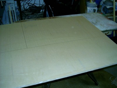

I used 1/2 MDF. I had to special order a 4 x 8 sheet at the lumber yard because they only had 3/4. I guess you could use it but I didn't think it was necessary and that total extra width of a combined 1/2 inch might make the difference in being able to move my seat back comfortably like it does now.
Use a t-square and rip your 4x8 sheet exactly 18 inches. The width between the back of the seats is about 22 inches but I didn't want it right up against the vent for the computer and possibly over heat it!
With this piece you'll be able to get your two front pieces and one back. Cut two pieces 28 1/4 and cut 26 1/2 from whats left for one back. Then square 18 inches again on what's left after your first rip and cut your other 26 1/2 for the other back.

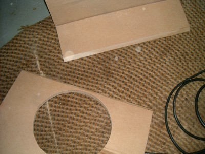

Now take your two 28 1/4 pieces (fronts) and cut out your holes for your ten inch speakers. The holes need to be 9 3/16 in diameter about an inch from the bottom.
Now make the bottoms from what's left after cutting your 2nd back piece. They both will be 18 x 5 1/4. If you have a table saw, 45 the bottom of the front and one side of the bottom. It'll be easier to nail/screw them to together after.

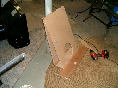

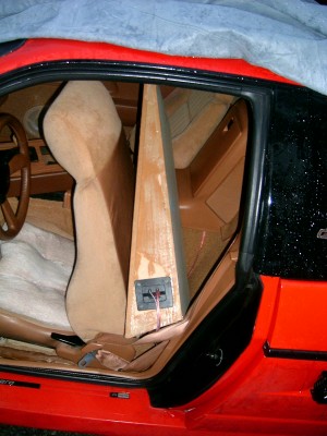

Next, stand up your box like the way it needs to sit behind your seat angled. I used P/L construction adheasive on all the seams. I then put a couple of screws (pre-drill) in each corner to sturdy it and then put about five panel nails (the ones with teeth!) acoss the top and bottoms.

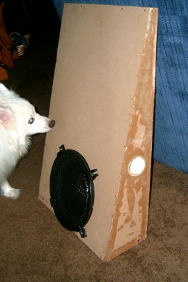

Next. Fit your speaker in just to make sure it fits nicely without touching the back of the box
Next. Place your now sturdy box on the MDF you have left and trace your sides. I found this easier then trying to measure this difficult angle. I taped a pencil to a long dowel to get my mark to the corners. After you've made your four sides, cut your hole in two of them if you want it ported. I used a piece of 2 inch by 2 inch pvc for each one. Then use the other two sides for your speaker wire connections. Fit them into your boxes, predrill and nail them securly and P/L all edges.
My poochy thinks MDF stands for "maybe dog food!"

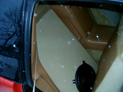

Report this Post03-12-2005 10:33 AM Click Here to See the Profile for GokartSend a Private Message to GokartDirect Link to This Post
Gokart
4635 posts
Member since May 99

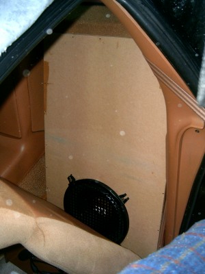

Nice fit and ready to carpet! It was snowing when I took this pic
They sound awesome and what a difference making the edges meet at the top! I was able to move my seat back where I always liked it and the MDF makes all the difference! Okay...I'm done
[This message has been edited by Gokart (edited 03-12-2005).]

I put my seat back all the way, I'll have to go out and check to see how much room is left behind the seat. Nice job, they'll look excelent with some carpet to finish them off.

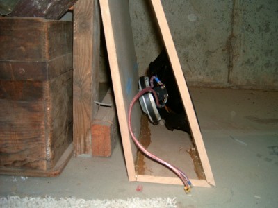

I'm hoping I can find something like that felt tan fabric that lines the piece around the center console! That would give it a factory look! Cliff, I've used ALOT of bandwith this week with all these pics $20.00 donation to PFF on it's way
Here's the amp that's powering them!
