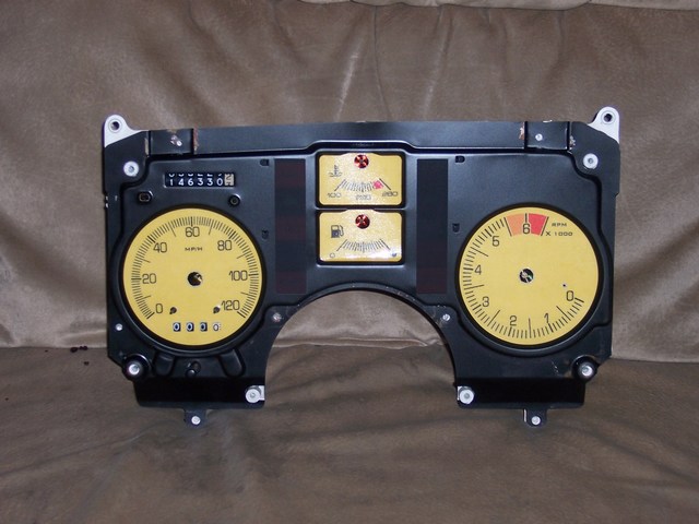

Ok, I'm looking at the gauge plates that AusFiero has on his site, and would like to make and install the yellow with black lettering.
But If I am correct, the lighting would still be orange correct?
I would need to repaint the orange that is supposedly on the back of the gauges to another color I think, because having yellow gauges with an orange light would make it kinda hard to see.
Any suggestions on what color would be best behind yellow?
EDIT: Ok bear with me. Just had a thought.
If the white face gauges are all lit up and the lettering is black, then would the yellow face gauges do the same thing?
If this is so, it would probably be best to paint the orange a bright yellow instead to make the yellow brighter. Or at the least, a bright white reflective color to brighten the yellow. Am I on the right track? Or am I way off?

Here are mine up to this point. Haven't glued the new auge plates down yet. Gonna wait till I make sure it lights up OK at night.
Tell me what ya think.

On mine I printed the gauges on velum as well. After placing them into the cluster and shining a flashlight through the hole the bulbis in, I could see too much throught eh gauge itself. So I placed some white self adhesive on the back. After that I covered the face with clear adhesive laminate to ive it a little shine.
I'm extremely happy with how it looks in the daylight, but haven't been able to see how they look at night yet.
My goal is to have the yellow glow. Hopefully it will work. I still need to paint the inside of the gauge cluster white. I'll do that today if I can and see how it looks tonight.
Kohburn, when you made your 150 gauge, how did you adjust your speedo so that it read corectly?
EDIT: Achawkins, when I went to attach the gas and temp gauge, I just made it the same shape as the orig, and folded it in the same place. I plan on centering up the needle holes and the bottom where it's folded. The test fit is perfect, so all I have to do is just spray the adhesive on it and place it on.
Also, as far as using double sided tape. I don't want to add anything behind the gauge face that might diminish the lighting from shining through the yellow part of the gauges, so I'm using spray adhesive.
[This message has been edited by slickrick2000 (edited 02-22-2005).]
I replaced the crystal in the 85 speedo with one of these
I used multiple layers to make the black stay dark when backlit.
if you want a color to light up you can look into the EL film as a backer and not worry about the backlighting lightbulbs.

Report this Post02-25-2005 09:43 PM Click Here to See the Profile for slickrick2000Send a Private Message to slickrick2000Direct Link to This Post
Well after being very disapointed in how my gauges lit up at night,lots of shadows and not an even lighting behind the gauges, I did a quick search on ebay and found these.
http://cgi.ebay.com/ws/eBayISAPI.dll?ViewItem&rd=1&item=3875771126&ssPageName=STRK:M EWA:IT
They are even the color I want. Not bad for $15.00. Hopefully this will get them up to my standard of how I want them to look.
After I get em, I'll probably be asking you guys about hooking power to them. I.E. can I run power to them all in a series, or do I have to run power to them all separately?
Thanks Kohburn for the idea of using the EL sheets.

Ok I finally got my EL sheets today that I bought on Ebay. See the link 2 posts up.
Now I need to try and figure out how to power them up.
They are supposed to be able to be lit up by 110VAC, which I suppose is straight 110 from a standard outlet.
Now the question for the electrical experts is how do I convert 12volt from my car to work with these?
USFiero suggests an AC Converter. would that work with these?
Once I get these powered up and make sure they work, I am going to cut a hole in one and see if it damages it. I got 10 for 15 buck, so not too big of a loss if I screw one up.
Help me out guys. I'd love to get these in my dash soon.
I don't think you want to do that.
EL works off of a tiny amount of amps, but high frequency AC volts (vary the frequency you vary the color on some). It'll give you quite a zap(yes I know from experience). So you need to convert 3,9,12VDC or 110VAC to (guessing)100VAC @ 1000+Hz
Contact Ed from Being Seen. That's where I got all of may EL material. ask him for the grey inverter. There are black and grey(last I inquired). The grey ones are more powerful. I do have several of both laying around as well as lots of sheets. $800 in experimental stuff. I could not get a durable electrical connection out of the material, and I lacked dies and such to knock out the holes....and realized I could not sell them.
