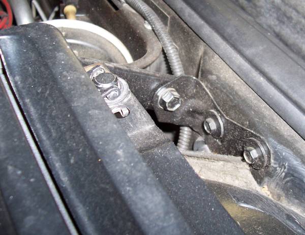

Here are the pictures I mentioned.
The first picture is my top bracket. I used the factory pivot and reshaped the Fiero bracket to wrap around the rear deck hing. I then used the top hinge bolt to secure it into place.

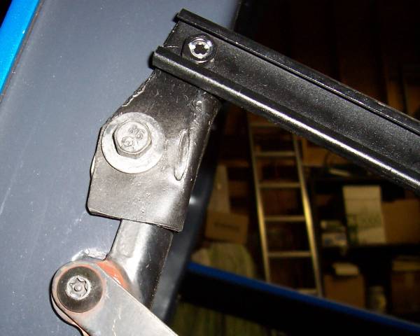

Again, I reused a piece of the old Fiero bracket to fab the lower mount.

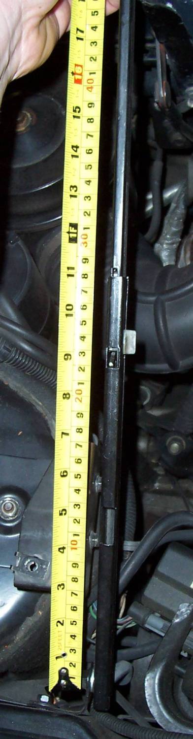

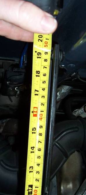

If I remember correctly, I had to shorten the lower portion of the prop rod. Use the tape measure as a reference to make sure when you make your bracket. Note where the locking points are. Be sure that your bracket will latch the deck lid open without over extending the opening angle.
Here is the rest of the length (sorry, I couldn't get far enough away to get the whole rod in one shot AND hold the tape measure at the same time ).
I think these pictures will be enough to help you make your own.
