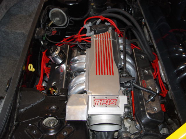

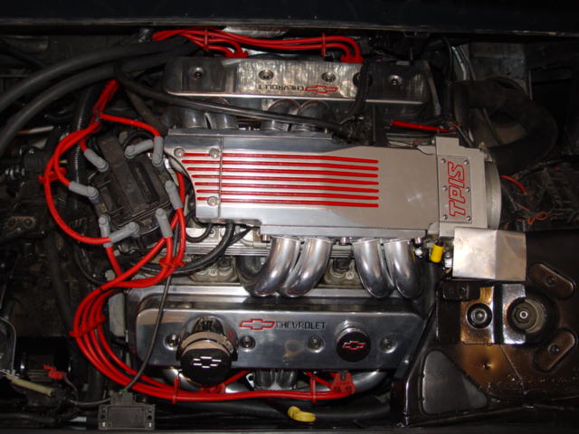

Report this Post01-11-2005 04:36 PM Click Here to See the Profile for LT188GTSend a Private Message to LT188GTDirect Link to This Post
I guess this would be my answer.
Two years of faithful service (as of two days ago)
newfie
Posts: 711
From: Back on the Rock!
Registered: Apr 2000
Report this Post01-11-2005 05:42 PM Click Here to See the Profile for newfieSend a Private Message to newfieDirect Link to This Post
That LT1 really looks sweet, especially with the reversed intake. Thats about as 'factory' as a V8 can look in my opinion. I'm still undecided however. I'm looking for more options as far as the ZZ4. I think the zz4 with holley stealth mpfi would be sweet, but pricey. Maybe I'd go carb first until I could afford the MPFI.

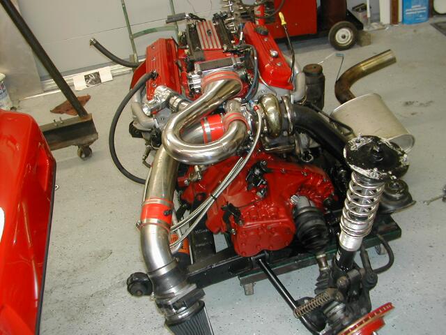

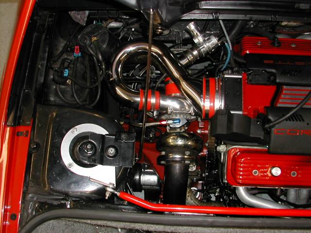

Report this Post01-13-2005 07:16 PM Click Here to See the Profile for MotorTVClick Here to visit MotorTV's HomePageSend a Private Message to MotorTVDirect Link to This Post
I like my LT1... ;-)
Chuck
newfie
Posts: 711
Report this Post01-13-2005 08:26 PM Click Here to See the Profile for newfieSend a Private Message to newfieDirect Link to This Post
WOW, chuck do you have any more details on the buildup of that??? A turbo LT1, I never thought it would fit and the install looks awesome.
