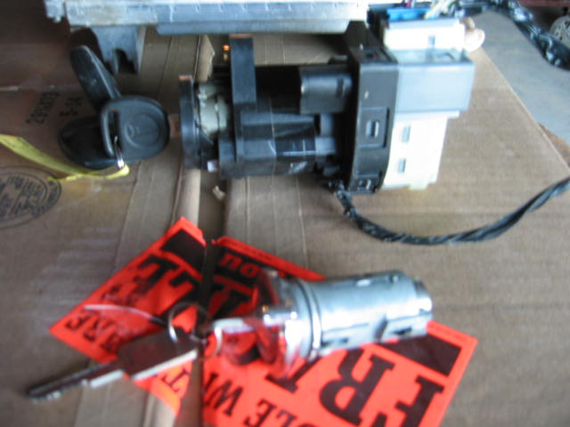

Everything always has a price tag around here. I built this car to learn the OBDII passkey 3+ system, Electronic Throttle Control, and try the paddle shifter transmission out. I like the paddle shifter feature. I still dont like where I put the buttons, but I feel it is better than the steering wheel. I am really going to try the T handle shifter in the days ahead. Maybe even voice command would be better? Then you would have to leave the tunes turned down.
I have a LS1 on a 4T65eHD transmission today. I want to change direction with that and install the Comp G paddle shifter transmission on that now. I will have to get the help of HP Tuners getting the code for the paddle shifter into the LS1 PCM since no vette or GTO is coming out with this feature. My best hope is that the 2005 Grand Prix that is coming out with the 5.3 V8 will have the Comp G package and paddle shifter feature in it. Then I can buy a wrecked 05 and move all that to the Fiero very easy. You have to know OBDII and CAN (Controller Area Network) in order to work with the 04's and 05 stuff.

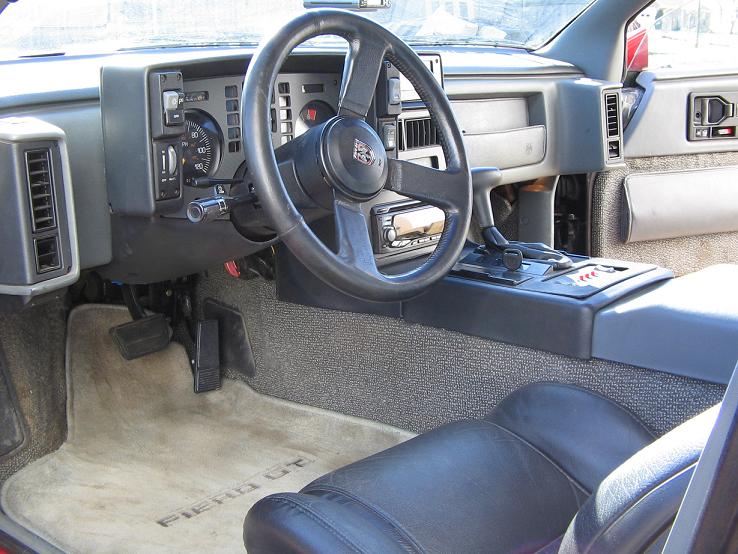

Loyde
Hey Loyde, I'm glad I got to see this car in person as well. I kept thinking it was my car, I guess just wishfull thinking.
As for the shifter button locations, here's a thought, why don't you get a conventional manuall transmission 5 speed shifter, (or however many speeds the 4T65eHD has) and modify that with microswitches and a little software to operate the paddle shift function. That way the mind doesn't have to be retrained. I've never seen this done, even on OEM, so you might have a one of a kind really cool setup. The auto transmission is the one thing stopping me from wanting a high horsepower engine for my Fiero.
1988 GT (Firebird Interior),1988 Fastback (4.9 Chop-top #1 of 1), 1984 Indy...Firebird Interior Installation Website

Report this Post10-11-2004 01:38 PM Click Here to See the Profile for revinSend a Private Message to revinDirect Link to This Post
Loyde,
I think we forgot to re-program something oh well later this winter ...
As far as a spot for the switches...what about a old high beam/low beam switch on the floor?( like older cars had) or do you need 3 switches?
How about three small shifters like the old Grand Nationals<? had? only shorter like 3 or 4 "???
Oh and MAN those ser 3 motors are almost as fast as the old ser 2' s !! j/k had fun finding that out! do you know what our speed was?

Originally posted by revin:
Loyde,
I had my laptop with me. It would have really taken longer to get the LTFT and STFT's correct to really have a proper tune. The scanner requires 15 minute drive times to get the histograms to load the charts with the correct info. Then I have to decide where the changes are made.
I would say the low speed roll ons I had you by a little, but the faster rollon's we seem'ed fairly equal. I saw 120mph, but thats all the speedo goes to... I have been 130 with the OBDII scanner running. Its reads the PCM, so I can log it also.
Dont you have a VS cam in your engine?
I thought of a floor board up/Down button, still not what I am looking for. I drive with the left foot brake method most of the time.
Loyde
Loyde
no just a 3.4 pulley, maybe it is the NO AC?
and it could feel like you are just hitting the clutch pedal

make it a foot controled shifter like a motorcycle but a rocker pedal, or just go all out and remove the steering wheel put electric assist steering rack in and drive your car with a playstation controler, your almost there nice install by the way im quite jealous
Loyde
Loyde, I got to thinking about your paddle shift and I think I have come up with a way you could mount it on the steering wheel and retain the function of the horn. The horn relay sends 12v B+ (thru the coil) and up to the horn buttons. When you hit the horn buttons this signal gets grounded which pulls the relay coil closed to send current to the horns. Well this means that any time the horn buttons are not pushed, you have 12v B+ (low amps) and ground present at the steering wheel. Well, I don't see why one could not utilize this power source to power a weak radio transmitter hooked to your paddle shifter buttons that could activate a module under the dash to send the correct signals to the PCM for upshift and downshift commands. Even if the horn relay circuit did not supply enough current you could always use a battery operated transmitter (there is pleanty of room in the steering wheel). Just brainstorming, something for you to try out if you get a chance.

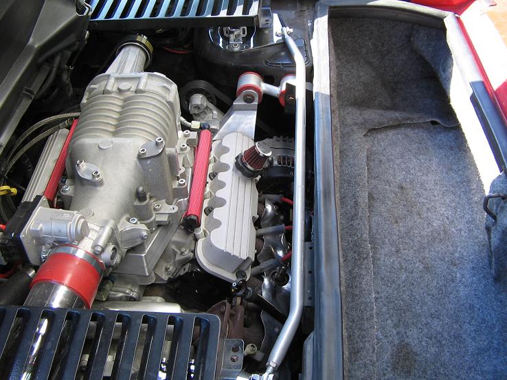

Hey Loyde, why dont you switch the valve covers? Me and Amir were sitting here discussing it. On my car it would be a huge b1tch to fill it with oil if i hadnt. I have to much wiring harness up under there by the decklid springs. Just wondering.
Ryan
FastFieros
Posts: 2698
From: Dallas Texas USA
Total ratings: 265
Report this Post10-15-2004 11:14 AM Click Here to See the Profile for FastFierosClick Here to visit FastFieros's HomePageSend a Private Message to FastFierosDirect Link to This Post
Well Ryan, here is my explanation to that valve cover oil fill issue.
When you install engines that are 30k or less, you are installing a engine that with all expectation is going to be a efficient running and a normal engine. No oil burning, no oil leaking, just normal. When I raise my decklid, the first thing you see is the supercharger and that trunk side valve cover. I like that area good and clean. If the valve covers are painted with different colors, the valve cover really stands out.
So, you change your oil every 3 months, or 3000 miles. I think to have a nice clean install, I can put up with using a funnel I heated up and designed to make pouring that oil in that firewall side valve cover every 3 months or 3000 miles. I don’t take that oil fill off once a week just to see if it still comes off, so out of site, out of mind. All my installations are very wire “managed” so, I don’t have that problem with a wiring mess above my valve covers.
Loyde

Here is the problem with the passkey 3+ switch.
As you see, the Grand Prix switch is really large. It has to be used because it has the Power Master Mode setup contacts in it. The BCM knows when the key is inserted, the key is turned to ACC/RAP, the key is turned to run, the key is turned to crank, all these positions setup the PCM to know what is going on during the start cycle. The reason is ONE TOUCH starting. The 03 trucks even have it. It is documented very lightly for some reason. The key is turned to the start position and you can let go the key instantaneously and the engine will continue to start until the engine is running. The key does not have to be in the crank position the continuous time. If there is a engine problem and you have a no-start, the DTC is set for no-start and a time out occurs at 10 seconds crank time.
So, I had to find some place to put that huge switch and the ash tray area fit. I mod’ed the hole for the key to be inserted and turned with no problems.
I hope that helps in understanding the construction and direction of this install.

Hi all,
Why are there three buttons??? One for up, one for down, the other for??
FastFieros
Posts: 2698
Total ratings: 265
Report this Post02-21-2005 01:51 AM Click Here to See the Profile for FastFierosClick Here to visit FastFieros's HomePageSend a Private Message to FastFierosDirect Link to This Post
Originally posted by pavo_roddy:
Hi all,
To answer your question about the buttons. The center one is an open option. The buttons were the ICCU control buttons. The ICCU was never installed since I got the 2004 Grand Prix PCM support from HP Tuners. I now today also have 2004 PCM support from DHP's PowrTuner.

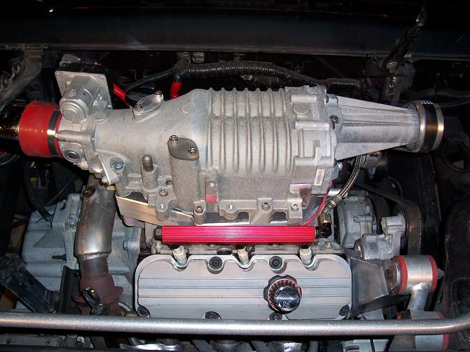

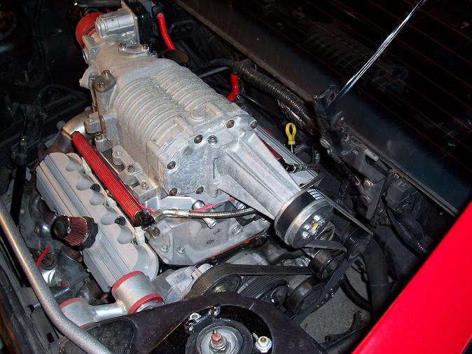

I also have sold this car. I just installed a ZZP Stage 2 IC and a set of Stage 2 heads. I have been updating the interior items as well.
Couple of pics so far...
Thanks for checking
Loyde

Hi all,
What exactly does the air filter placed in the oil fill hole do.......lol, that sounds confusing to me....
Will you let us know when you get the comp g package working with the ls1 if that is the goal......?
FastFieros
Posts: 2698
Total ratings: 265
Report this Post03-11-2005 12:20 AM Click Here to See the Profile for FastFierosClick Here to visit FastFieros's HomePageSend a Private Message to FastFierosDirect Link to This Post
The air filter in the oil cap is a breather point. The 3800SC builds alot of bottom end pressure and will show signs of oil leaks as early as 8k miles around the valve covers and oil pans. If you put this breather in, it will lessen the pressure build up alot. ZZP sells unit for $45. Mine is $12 and drill a 1/2 hole..
