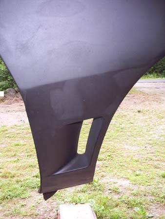

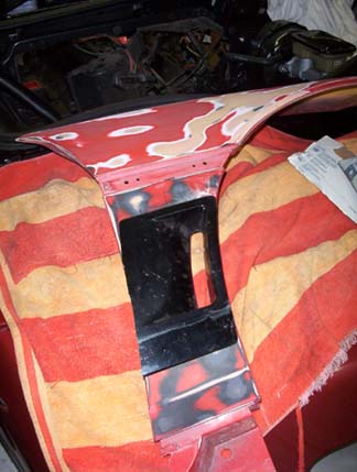

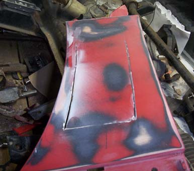

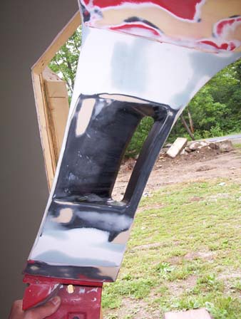

This is the way I did it...
I put set the vent onto the fender where I wanted it and traced the out line of it onto the fender.
so I had an idea of the size.
after that I measured the back of the vent where the curve is....because that is all you will need to cut.
I transfered that to where the cut is to be made in the fender.
Then I cut it out of the fender. As shown above. Then just place the vent into the hole in the fender to make sure it lays down flat.
keep trimming until it lays flat on its own. adjust as needed to make it sits where you want it.
you must cut of all the flanges on the back so it will sit flat, EXCEPT for the ones that hold the grill in place.
Then I glued it will two part epoxy , clamped it together and let it sit overnight.
You will notice that part of the vent hangs over the side of the fender...I cut mine off at a curve for filling later on.
Then comes the fun part....making the mess. Since I also shaved the trim on this peice it was more work.
making sure it is strongly held in place (movement means cracking) , you sand the lip off the vents where they touch the fender. then to smooth that out you can fill it in with your choice of bondo ( I use boat bondo) .
It may take quite a few coats in order it to take the shape of the fender. The edge of the vent I cut off, was filled with resin and then bondo was applied over it to make the taper of the fender.
When you are happy with it, you prime it with a sandable primer and then if you find something that you dont like, you can use auto spot putty to fill very small defects. keep priming it and sanding it until you are very happy with it.
Then paint it, take a picture of it and post it here so we all can see your work.
Hopes this helps. John
edited to add the finish project...
[This message has been edited by fiero67 (edited 09-03-2004).]

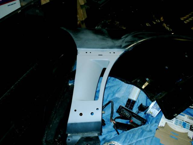

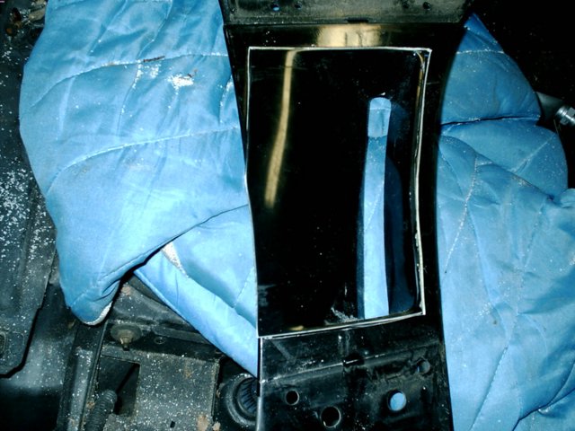

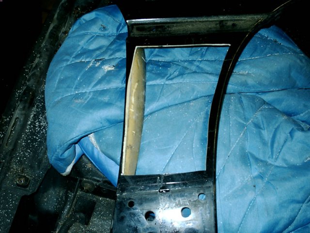

and still....another way.
i trimmed off the whole trans am vent flange and molded it INTO the fender. not behind or in front, but flush. it worked great and i used way less bondo/filler i think. it boils down to which way you like. they way i did it forced me to build a fillet on the inside for a little more strength. anywho....
her are a few pics.
cut-out
vent trimmed and sitting flush
roughed up and filled in
i still have to finish them off but this should give antoher option. a few others have done it this way too i believe.
edit...for the cut-out. any way you choose to do it.....lay the left vent upside down on the right fender and trace it out. vice-versa for the other side. viola!!! a perfect fit every time with no measuring.
[This message has been edited by shawnkfl (edited 04-23-2005).]
