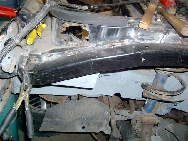

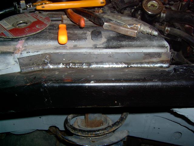

Here is a thread I posted a while back on the work I did on mine:
https://www.fiero.nl/forum/Archives/Archive-000002/HTML/20040710-1-040196.html
This is one Steven Rossi posted of the work BubbajoeXXX did on his car:
https://www.fiero.nl/forum/Archives/Archive-000001/HTML/20030531-2-032938.html
Hope these can point you in the right direction.

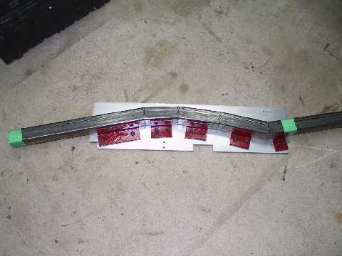

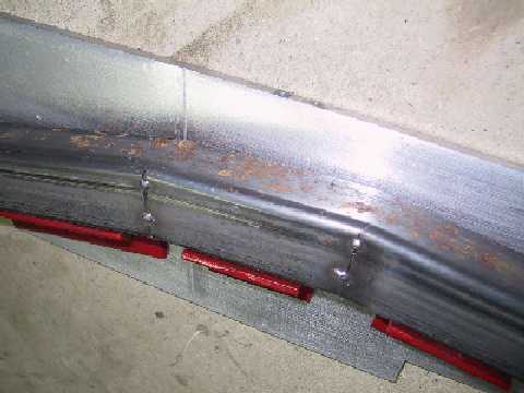

Thank you Arn for the plug. Yes, I am in the process of doing a complete resto with lots of pics. I did not start a thread because there have been similar subjects covered by other PFF members. Besides, I'm not the smartest when it comes to threads on servers, most of it is over my head. It took me six months just to get PIP to work. I am doing a rail resto for another 85GT Fiero owner who is not a PFF member, and the process is a take off from Steve Rossi's thread. My rail is one piece notched and bent in four places to represent the original as much as possible. Nothing wrong with Steve's, mine involves more work. I also made a fixture to make additional rails. I have numerous Fiero owners asking me to make them and possibly install them. I attached a couple of pictures that I have. The green tape represent the length before the final cut.
The pic (below) is of the rail in the fixture and tach welded. Unclamped of course.
The pic (below) is a close up of the opposite side where it was formed NOT cut.
Steve and others are right about rigidity. You must get good weld penetration. Stainless steel is a good idea. It takes a good knowlege of material to weld SS to HSLA material (High Strength Low Alloy).
Regarding the rust resto without sand blasting takes lots and lots and lots of elbow grease. You can use abrasive wheels, dremel with a deburring tool, scrapers or whatever takes the rust off. That takes dedication and want. "I want to do that" is different than "I like to do that". Time is also a factor. Hope this helps.

Yes, the fixture is designed to duplicate the rails. I also have a template to mark and cut the tubing when it's straight. Every rail will be the same. The only difference is where the rail is cut at each end to suit each application. One car was so bad, I had to fabricate both ends of the car. Under the rear window was a PITA. Was the work worth it? Yes, because material is $75, welding is $100, "I saved another Fiero".......PRICELESS.

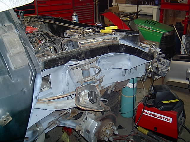

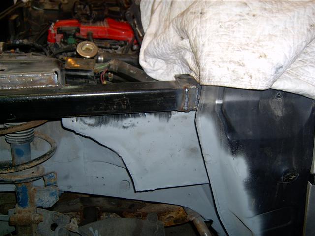

well did you check out my post about replacing the rails??? it shows what you have to take off the car. It is not all that hard to do just takes time and some planing i found i needed to weld a piece of flat bar to the top of the Made rails to give me something to weld the rail to the shock tower to
then if you wanted you could weld on some flat bar tabs at the end of the rail to attached it to the rear of the car i didnt i just ran acouple beads to hold everything in place and i might add shes soild!!!
edit: to add some more pics for you
this one shows how i welded it across the shock tower and at the front of the car before the firewall
[This message has been edited by 4BanGinFun (edited 11-02-2004).]
