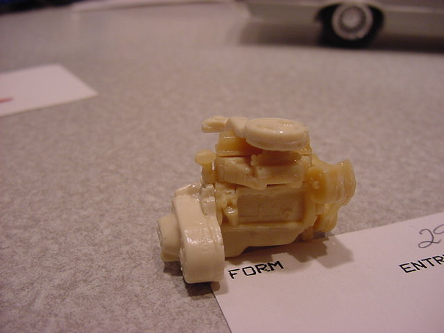

Vacuforming is a royal PITA. This is what I used to make an exact copy of the Iron Duke in the 84 Fiero kits (for my Indy Pace Cars)
http://www.alumilite.com/
They have good tutorials there, too. This is how I made the engine parts:
http://www.alumilite.com/howto.cfm?ID=2

Here's what the resin duke looks like built-up and un-painted
wow, that looks good! it looks true to the original!

Well Bob, it looks like you've got quite a following with the little Duke's... I'd love to have a casting too, if you think you can pop a few more. If not, email me on the side and let me know what mods you did to the kit pieces. I'm sure I can at least duplicate that.

I'll try today I'm working on finishing a Celica rally car for tomorrow's model club meeting, and for display at the local hobby shop. Plus my little brother's girlfriend called this morning and wants me to fix some "major problem" with her laptop, so I might not even get to try to cast the 'dukes 'till tonight or tomorrow.
The resin pieces are the same as stock in the kit, I just made the mold because I needed alot more engines The way I made the mold, there's alot of work involved cleaning up the flash and mold lines, but they look just as good as the original when they're painted up.
