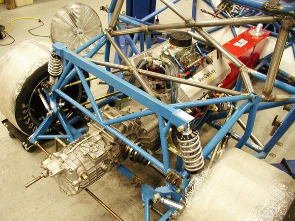

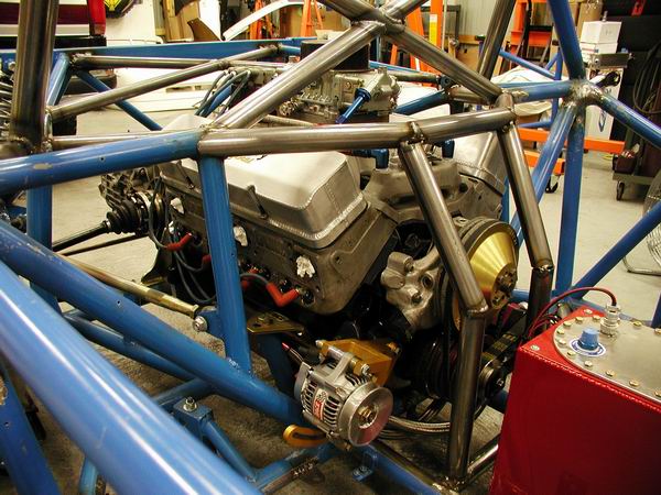

Maybe this will will help...........
Here is a picture of a longitudinal V8 in a tube chassis. The wheel base is stock, but you can see how much it goes into the cabin. This can be corrected or minimized in several ways. Since this is a race motor, The dry sump sticks off the front and taks up much more space than if there was a flat pully for the water pump and the alternater was mounted in the back. The advantage, as mentioned before is that the tranny's are typically stronger in this direction and the CG is generally further forward in the car.
In about 2 months I'll have the engine back in and you can stop by and see it. Or if you want you can wait until the Gateway show. (End of April / Beginning of May). I might have a track day at Gateway before that if you want to see it run.

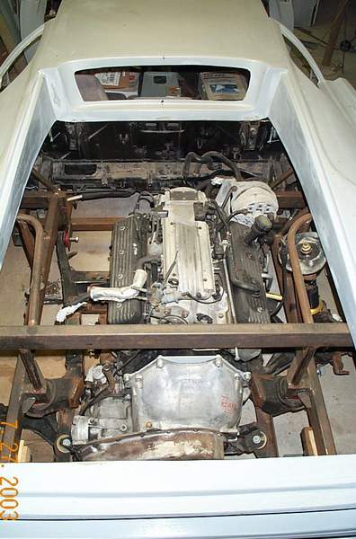

Lt1/thm325
Although shown in a Diablo w tubular chassis, the engine/trans/cradle assy will fit directly into a stock Fiero chassis, cutting out the center section of the front wall of the trunk.

The pic OPM200 is showing has the TH325/425 trans. This is the only (GM) trans that will fit long. without a stretch. The biggest problem is that it is an automatic. If you want a manual, then the longer Audi/Porsche trans is what you need.

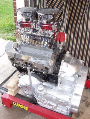

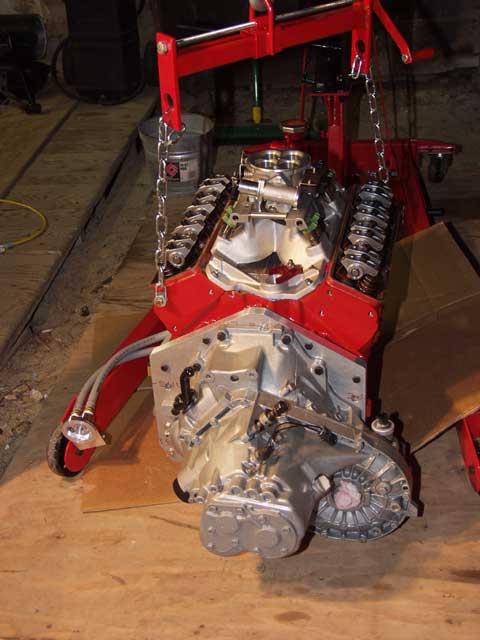

This picture should help clarify the weight distribution issue:
With the GM TH325, 325-4L & 425 transaxles the weight of the engine is always pretty much centered right over the rear axle center line. So, no matter how you configure it you're going to have more weight behing the rear axle. With the transverse setup almost all the weight is in front of the rear axle center line, between the wheels where you want it ideally.
If you mount the TH-series tranaxles the way they were designed the pulleys will face forward, and be right behind the rear firewall. As seen in David's pic this will put almost the entire weight of the transmission behind the axle center line.
If you reverse it, by flipping the differential, the pulleys will face the rear of the car, the weight of the transmission will be in front of the rear axle center line, and you'll have more favorable weight distribution. It will also lower the engine slightly for a lower CG. You are still moving half the mass of the engine behind the rear axle center line though (as compared to the transverse arrangement).
Here's what you have now (sort of):
