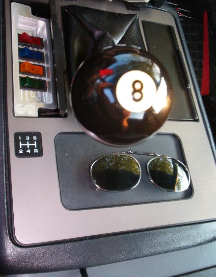

Alright, thanks for the helpful responses. One last question, anyone made their own shift knob out of a pool ball? I've got about 3 spare 8-balls lying around and thinking it would make a sweet shifter as long as you could drill a hole and thread it to make it fit on the shaft. Any ideas how to do this?

Or, you can do it the cheap and easy way like my car's previous owner did. Drill a hole in the bottom of the ball a little bit smaller than the shift lever. Then screw it on. As you screw it on, the threads on the shift lever will cut into the softer pool ball and it will be threaded.

It is a pain in the a$$ to tap the hole out in a real pool ball because the material wants to compress when you cut and then grab when you back the tap out. Drilling the hole is easy though

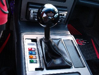

A friend of mine gave me this awhile back with the hole already drilled. It was threaded when I screwed it on. Shifts just fine!
