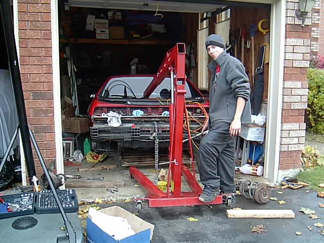

When I did both of mine I pulled the rear bumper skin off. Then I hooked my engine hoist onto the rear metal bumper and up she went............. Did it that way twice, one of the good things about that is you don't have to worry about bumper damage.

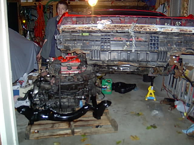

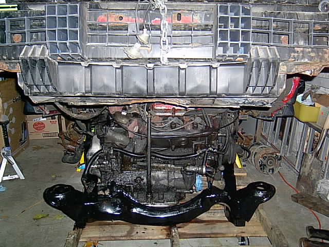

When I pulled the cradle on mine.. I used the two jacks, 4x4 and jackstands method..
However, instead of jacking up the front end, I drove the car up on a set of 8" ramps. I don't think that ramping the car was totally nessessary.. however, I'm big and fat and the extra clearance made it easier for me to get under the car when needed

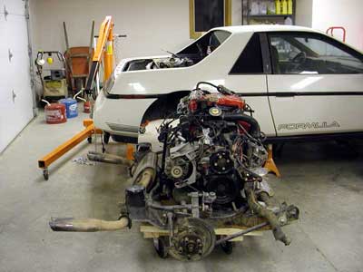

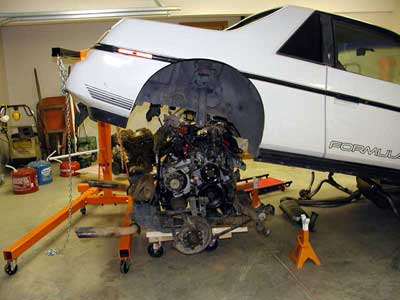

Before:
During:
After:

And to those young Fiero enthusiasts, never,never, never get under a Fiero without jack stands in place no matter what method you are using.
I think what crzyone is saying is that to pull the motor Straight back, you would need a little extra clearence by raising the front end. If you pull the engine out of the wheelwell, you won't need to do this. Of course, a lot depends on the dolly your using. Mine is tall. It sits almost 10 inches high.
I do agree with NOT using jackstands for the front. I would think it would be too tipsy when lifting the rear end. I raise the front end with ramps. Sometimes I do it, sometimes I don't. I don't need to do it. I'd say I've had complete cradles, in and out 15-20 times or more.
I do remove my engine straight back and you do not need extra clearance. I just pulled my 3800SC with a 2 inch thick intercooler under the supercharger and I removed it straight out the back. I would agree that if you are using a tall dolly you would have a problem but I am using a wooden skid with rollers mounted under it so it is not all that short in height either.

Well when i dropped my engine in me and 4Bangin4Fun lifted the back of the car up with an engine hoist by the back bracing of metal under the bumper! but started to buckle with the engine finally in ...but ya here are some pics and it helps with the trunk being alittle dented so you can slide the engine under just barley... was rubbing agaist the trunk !!
Engine being slid under from the side.. after going under the trunk!!!
Engine under with the car lifted high!!
Now engine in and hooking everything up.. OMG it was messy .. but alot of fun
