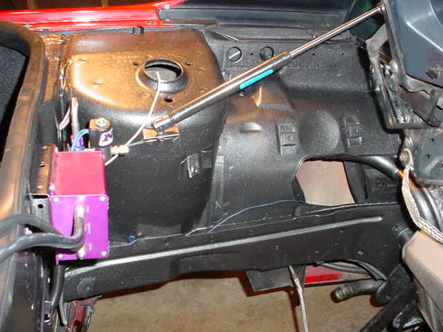

I think his is painted silver? Can't see from this angle but, strut towers are painted.

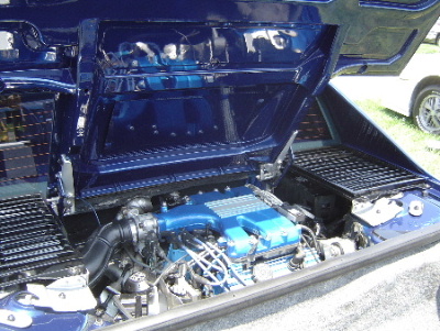

And Keith's N* bay

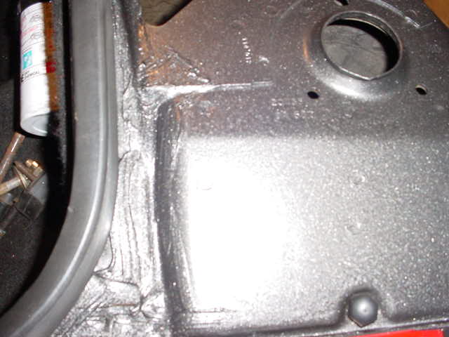

I used a textured gunmetal color paint for my engine bay when I installed my 4.9. Looks good and doesnt show dirt.

FieroMaster:
That looks better than excellent. If you don't mind my asking, how did you prep the engine bay before painting? That will probably be how I end up painting it if the white doesn't work out.

Well, I spent a good ammount of time with some degreaser (simple green I think) and some water. Then I washed everything down with dish soap and water. Did a little sanding with some 400 grit sand paper. I rinced everything down good again and let it dry, then sprayed the paint. I got the paint from AutoZone. It's the Duplicolor paint, I think it was called textured deep grey metalic or something of that sort. It looks awesome and turned out gerat. I normally suck at painting, but this paint went on soo easy it was scary!
Oh yeah, I forgot. I made sure everything was pulled out of the engine bay and stuff I didnt want painted was masked off really well.

I like the Silver.
