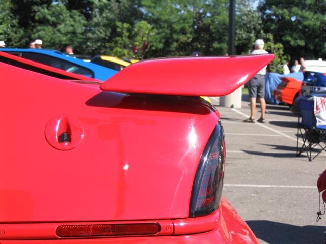

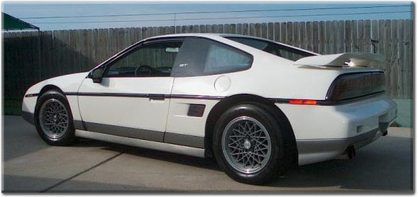

Mine was moved back by one bolt opening.
I'm not sure if this is moved back but it looks good, hehehehe.

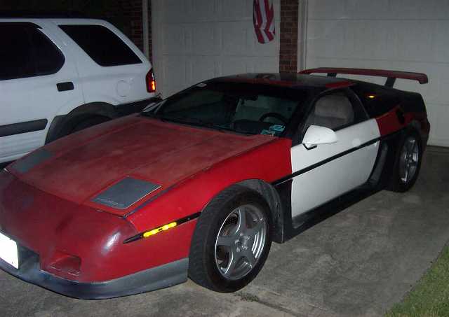

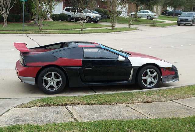

Revin has his back there too...

Those all look nice! I'd like to see stock wing heights, so if Revin's is stock, I'm eager to see his!
BTW Curl, your car just needs one more exhaust tip! Then it'd be perfect!
Christian Thomas
87 Pontiac Fiero GT Burgandy/Silver 5.7L ZZ4 5spd
Latest Mod: Poly Rear and Coilovers (HMS 350#)
madcurl
Posts: 21401
Total ratings: 314
Report this Post08-15-2004 10:10 PM Click Here to See the Profile for madcurlSend a Private Message to madcurlDirect Link to This Post
Ahhhh...look again I reposted one more stock pic. It's CA KID's GT. Exhaust tips? Long story.

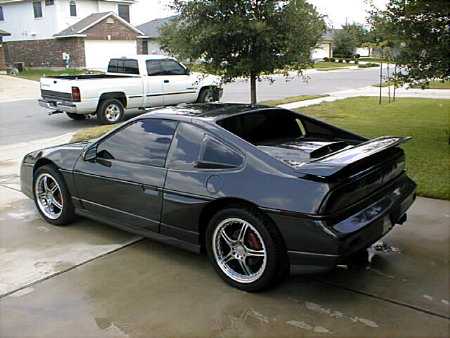

Well Here are a few pics of it. I think I moved it 1.5" back. Any more and the trunk starts to slope down and a wedge will need to be made for the stands then.
Hope that will work.
p.s. The orange GT is NOT a stock height. sorry curly. he had the stands made.

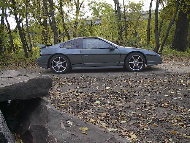

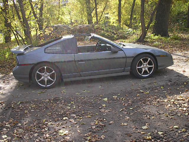

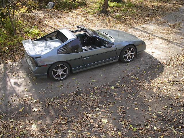

Here are a few of Jamie's old car. That fool never should have sold it.
Hope that helps in your decision. I don't know exactly how far back Jamie moved his wing, but he made it even with the rear bumper.

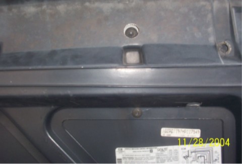

To make your choice very easy, just un-bolt the wing. Place the front threads over the second holes towards the rear. And thats it!. Start drilling. The end result will be a C-shape from the bumper to the bottom side of wing. Heres a before pic.

Oh use a rubber gromett to fill the opening. Otherwise it will look silly w/o it. And you I do have two exhaust pipes and its going back one, hehehehe.

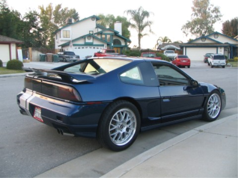

Report this Post09-14-2004 11:07 PM Click Here to See the Profile for Black-Azz-GTSend a Private Message to Black-Azz-GTDirect Link to This Post
This images is larger than 100K. Click to view.
Wow. This car looks alot like mine with that paint. I agree. The wing Looks WAY better moved back. WAY BETTER!

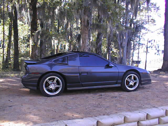

There are some threads showing good side profiles of mine - moved it back about 3 to 3 1/2 inches from stock (still stock height). The limiting factor on how far back you can go is the rear radius or curve of the decklid. If you go to far to the rear, the stanchions, which are nearly flat on the bottom, will not follow the curve of the decklid as it drops away. I suppose you could fill in the gap if you wanted to go further.
