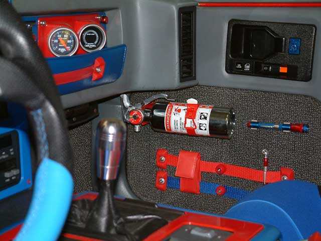

Here is one of the most creative mounting places I have ever seen.
However most off them seem to be on the right side of the centre console. Like where the passengers left knee would be. All the ones I have seen there have been mounted verticly
However it's not in jordans car

I keep my extinguisher inside the passenger foot area (simliar to where it is shown on Fiero5's car, but mine isn't actually attached). I personally wouldn't want my only extinguisher to be in the trunk... what would happen if the fire quickly destroyed the wiring for the deck release, or the relay and/or switch randomly failed at that moment? Or even if the flames were in the general vicinity of the extinguisher location. I'd rather already have it in my hand when it comes time to open the decklid

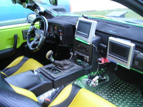

I have mine mounted to the bottom of my third brakelight.
[This message has been edited by Oneredfiero (edited 07-21-2004).]

Report this Post07-21-2004 02:02 AM Click Here to See the Profile for daniel87fierogtSend a Private Message to daniel87fierogtDirect Link to This Post
Good GOD dude!!! Give that poor fiero a bath
Did you remove your rear-view mirror too?

Report this Post07-21-2004 08:55 AM Click Here to See the Profile for FirefoxSend a Private Message to FirefoxDirect Link to This Post
Someone stole your license plate!

ok ok ok. Yes rear view mirror is removed replaced with radar. It was parked for the winter that's why the dirt and no plate. Now back to the thread. Lets see some more ideas for fire extinguishers.

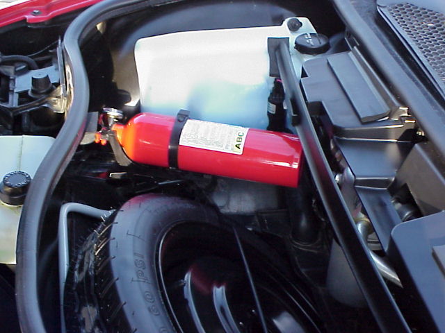

We also have one in the engine bay:
But as some of stated allready as more fires are in the engine bay we also have the one in the cabin as well.

Any more people want to show where they have their extinguishers mounted? Looking for ideas . . .

I attached mine right to the jack bracket up front. It was practically "bolt-on" because I used the existing jack hold-down bolt hole for one of the attaching points. And only needed to drill one hole throught the jack bracket for a second attachment.

i don't have any pics, but i had mine mounted verticly on the centre console, on the swing down door thing...
on my next i will probably mount it under the pass dash. people kept asking me if i had NAWS when it was visable. i don't know why.
Where's your jack?
