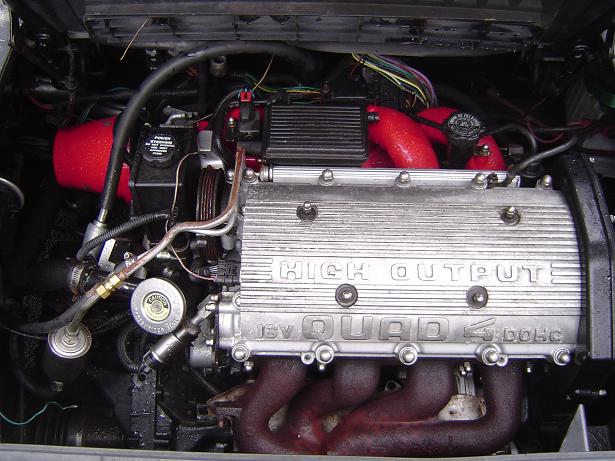

I"ve had a Quad H.O. in my GT for over 10 years and Im very happy with it. I put over 250 000 km with no problems at all, last year I baught a W41 Quad from a forum member and its even better than the H.O. Im looking forward to putting another 250 000 km on this one also. Most important thing to remember is to never over heat the engine and every thing will be ok.

Ive put about 500 miles on my Q4 so far. It doesn't feel fast like my 3.4 P.R. does, but It will put a whoopin on it!
Its certainly not torquey (sp?) like any 2.8. It requires 93 octane gas, but pleasently rewards you with EXCELLENT gas mileage. I drove approximatly 220 miles (from Long Island, to about almost harrisburg, PA) and only had to put 6.3 gallons in it to top it off again. 35 MPG! Around town and heavy right footed, it can suck gas down as well, getting only about 22 MPG. But thats what you get when you have 180 (or more) horses. I don't know about others, but MY Q4 doesn't really start to kick till about 4500, and pulls progressivly harder till the 6800 rev limiter. I've been told that they start to pull hard at 3500, Maybe its my exhaust and greatly enlarged Throttle body. I went with the rare 3.94:1 Getrag transmission, and I feel that It's gearing plays a significant factor in how this car drives.
