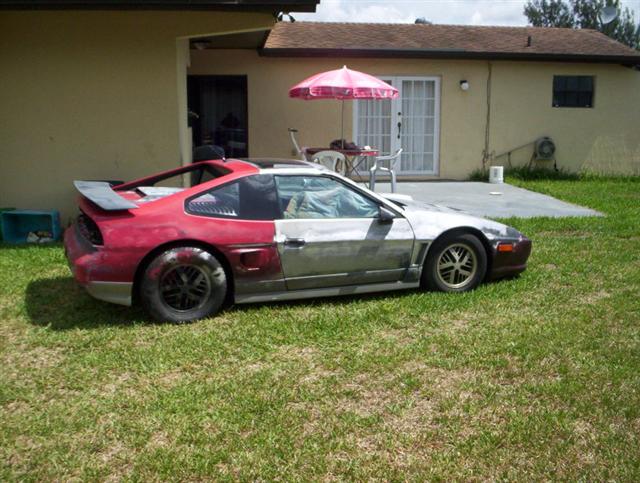

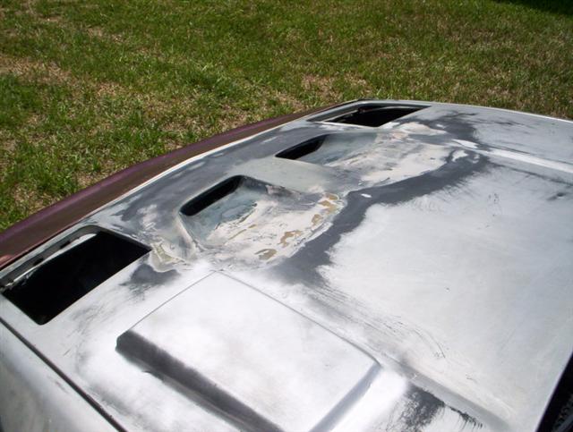

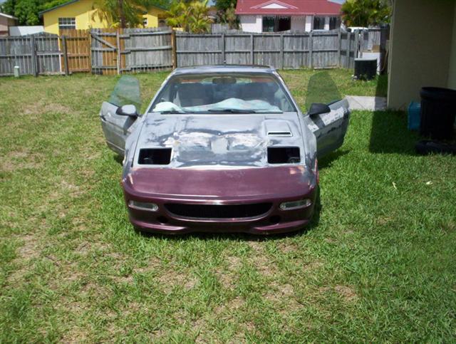

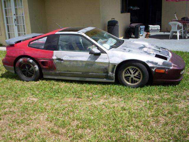

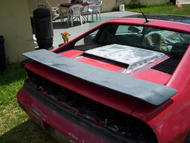

This is what I did to smooth mine in ,I shaved the moldings with a grinder till it is flushed with the panel then I use fiberglass filler to fill it in then sanded it after which I glassed it in then used a SMC filler and sanded it to make it nice .It has turned out fine and just waiting to decide the color paint I will be using Ferrari rossa red or Mellinium Yellow just need to make up my mind .

That's a pretty sweet car ^ ! The scoops look pretty radical. You'll have to give me some more pics of that baby. Post 'em here or email them to me at thekidd@cox.net
