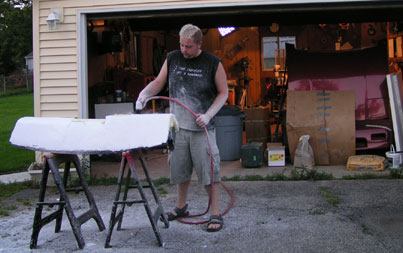

Yep, I made the mistake of using plain ole white styrofoam for a plug for my dash mold. This is why not to do it:
As you can see, I had it all over the place. It has a lot of static, and sticks to everything. I hope it's not too bad for your lungs, because I am still hacking it up almost 4 hours later. Next time I will use a different kind of foam.

Thanks for pointing that out guys, but I already plan upon coating it with either shellac or latex paint.

It may be a while before I finish it, but I plan upon puting a layer of resin and fleece on it soon. I'll be sure to let you know how it works. The Fiero in the garage is my current project car that the dash is going into. I don't really have a design on paper, just some ideas in my head. We'll see where it goes from there. This is my first major fiberglass project. I'm excited to see how it's going to turn out.
