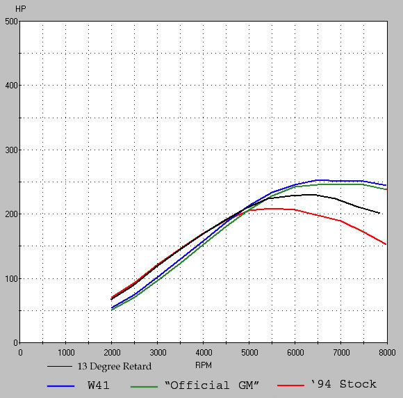

This engine was on display in Detroit some time ago. A prototype version made 281 hp N/A. It had an upgraded computer, and VVT or Variable Valve Timing. Not dis-similar to the 3.6 DOHC being released soon the the Caddy world in 2005.
Here is a great link for ya..
http://www.angelfire.com/ca2/34Performance/

You can get 240 just by changing the timing, more if you get cams cut for it. Surely a Port and Polish job would do wonders on a high revving engine like this. Im sure there are other improvements to be made, but I think destroking is moving in the other direction, theres no replacement for displacement. You'd loose torque and power by destroking it, you might be able to get that power back in the top end, but honestly I dont think it would be worth it. You would have to custom make an intake(which has been done, with good results), and headers, plus worry about a lot of other things to raise the red line that much. If you want to build a $5000 racing engine, go for it, but if you just want a fast car, Id stick with more conventinal approaches, especialy if you want off the line power. I think cam timing and a good P&P job would do wonders.
