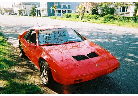

well here it goes

sweet it worked

Nice looking 85 Coupe. What vents did you use for the hood? I love the All red job! all you need now is White or Black rims

Hey thats an old pic.......wheres those rims? hmmmmmmmmmm?????

The vents are actually the honeycomb mesh that is under the rear engine vents. cut to shape and glued in. The paint looks way better in this pic than it actually does on the car. those rims are on your car eric ,ha ha (in nelson voice)

The all red is lookin pretty sweet. Even red wipers.

Very nice, I like !!
Can you post a closeup of the vents ?

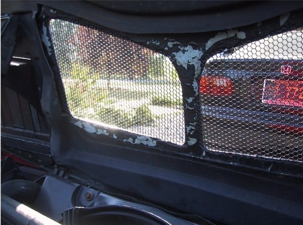

ZOOM88 here ya go!
don't mind the chipped paint its function over form right now
I cut the holes as to not disturb the weather seal then cut the mesh about a half inch bigger to give me a good amount to glue the edge down. I used a metalset two part epoxy kinda like jb weld that has a 2 hour cure time and also used weights to prevent vent from popping out of the epoxy. this mod was done to help a overheating problem i had (did cure it but thats a differant story).
