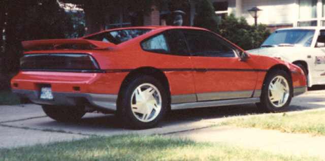

Report this Post06-02-2004 12:46 AM Click Here to See the Profile for ErikSend a Private Message to ErikDirect Link to This Post
Here are the GTZ wheels from 1990 to 1993 GTZ Beretta on one of my Fieros
