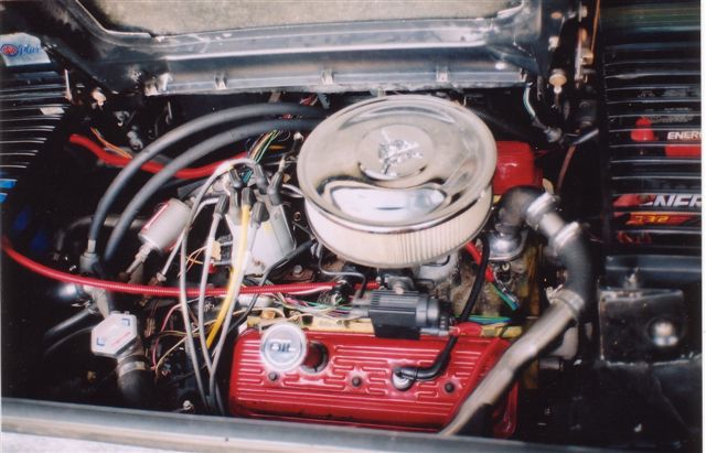

I can tell you this, they look nice in the car and they go! We have two owners in toronto with 4.3L engine in their Fiero's. One is a member on Pennocks who goes by "vortecfiero", the other owner browses the forum once and awhile but doesn't post.
Here's Mtt's car (non PFF member)
