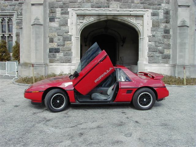

this is a forum members car there was ALOT of pics of it, but this is the only one i have

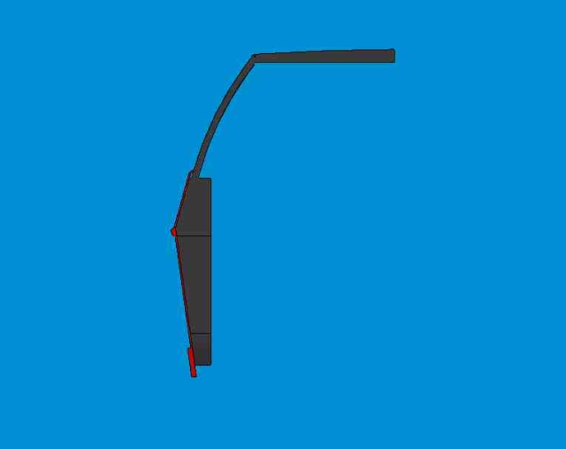

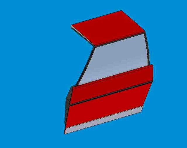

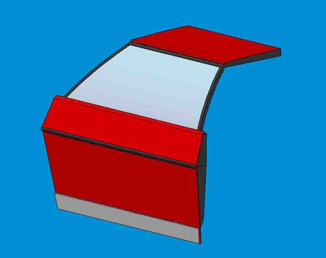

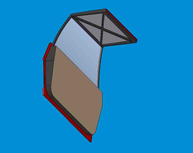

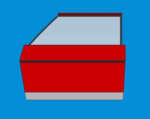

ok, I have some images of the gull-wing concept... I can't seem to figure out how to post them though... can anybody help me?

ok... these are really rough concepts. If anybody has another approach, pm me & I'll model up a concept. Be patient with me though!! I move kinda slow!!!
