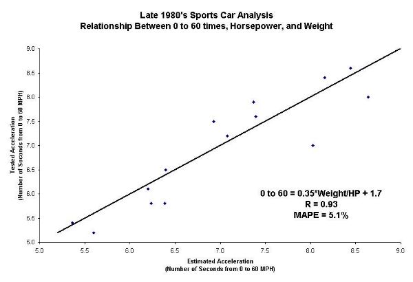

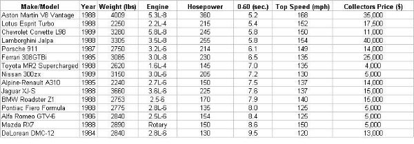

Like most simple models, these are "generally right but specifically wrong". In other words, they do a pretty good job explaining all the points collectively, but any given point can be off somewhat. As an example, I did an analysis of sportscars from the late 1980's including the Fiero. Part of this analysis was a simple model to explain their differences in 0 to 60 times using only curb weight and horsepower. The model explaines about 85% of the differences between the cars. On average, the model is off from any car by about 5%. For example, for a the formula fiero, it predicts a 0 to 60 of 8.6 seconds while the actual published time was 8.0, which is off by about 7.5%. For an 84 coupe, the model would predict a 0 to 60 time of 11.1 seconds, while a published source has it as 11.5 seconds, a difference of about 4%.
I guess the moral of the story is that a simple model will yield simple answers. For more precision, more precise models are needed which will take into account other things such as type of transmission, gearing, tires, temperature, driver weight, amount of gas in tank, etc. Here are the details of the model if you are inerested:

Report this Post04-20-2004 12:43 AM Click Here to See the Profile for NotorioSend a Private Message to NotorioDirect Link to This Post
Ffindley, great job on the graph and model. California Kid, thanks for posting the numbers w/engine on a swap (i.e. in the picture). So, to get in the ballpark of 0-60 in 5 seconds, a rough estimate would be 300 hp. That would suggest a 3800sc dropped in "as is" (260 hp) would turn mid 5 -- very respectable. How wrong am I ?
