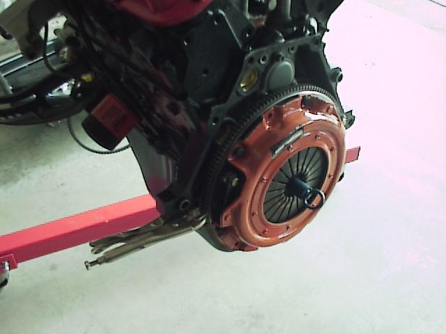

Your picture confirms my suspisions about the clutch line. You need to remember that that is a hydraulic line and it will be subjected to high pressure. If you can reflare the end, you might be able to save it, it doesn't look like you will be able to because the stub you have left is pretty short. Don't feel bad, I kinked mine when I was taking the engine out the last, and it wasn't even my first try at removing the engine as I had done it before. Lucky for me the kink wasn't too bad and I was able to reuse the line. www.fierodave.com has some NOS ones or the Fiero store has them if he can't supply you with what you need. Good luck and keep us updated on your advances.
I'll take a closer picture for you, but I didn't actually damage the line itself. The part that twisted apart is the less than an inch long connector that the line screws in to and that screws into the pipe coming off the transmission. I don't see why I wouldn't be able to get a new connector and be good to go.

For future reference, the thing to do is to unbolt the slave cylinder, and tie it off in the engine compartment. That should prevent damage to the line, rather than undoing the line. Now, you'll not only have to repair the line, but bleed the clutch hydraulics.

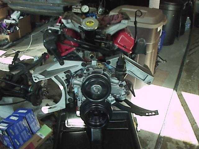

Ok, now for today's progress report!
Today I spent a lot of time running around getting stuff I need. I went to Kragen and got new oil, some treatments, and some paint to take care of the valve covers and plenum. Then I realized I forget my wallet had to go back home and get it. Once I got the stuff from Kragen, it was off to 2 different tool stores looking for something to get a freeze plug out with, then to 3 different car parts stores and a GM dealer looking for the connector for the end of the clutch line. As it turns out, its all one big line, not just a connector on the end. This is as I feared and in keeping with Murphys Law. On the bright side, it looks like Avengedor might have a solution for me.
On the plus side, I did get work done today. The crank pulleys, harmonic balancers, timing covers, and lower plenums are off both motors. The 3.4 is all stripped down and ready for parts. The 2.8 is stripped down except for the oil pan. It needs to be liberated from the cradle and trans first, then I can pull that too.
Getting the pulleys and harmonic balancers off was evil. Even with the right tools they did not want to go, specially the 2.8 balancer. Had to rig up a crazy set up with the engine hoist to keep the engine from turning over while I used the tool to pull the balancer. Let me just say that the impact wrench is the greatest tool ever. It took me and Eric a lot of force to get the pulley off the 3.4 and the impact wrench took care of the 2.8 pulley in under a minute.
Also today I finally got around to porting my other exhaust manifold. I couldn't get to the front one while it was in the car, but since its not anymore, it was easy. Cheapest horsepower I've ever gotten.
Picture time!
A shot of my work area at the end of the night.
A different angle. You can see the two lower plenums on the cardboard, as well as the 2.8 timing cover. The 2.8 parts were really gunky so they were being degreased.

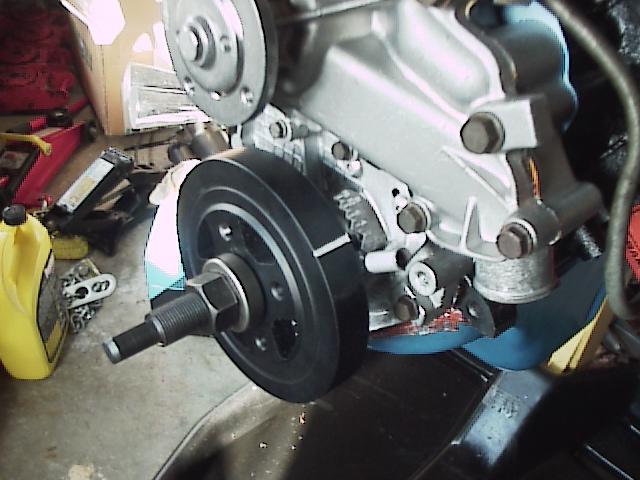

Heres a look at the 3.4 all stripped down and ready to be put back together with 2.8 parts. My big box of 3.4 parts is getting really full.

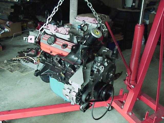

One more tonight. This is whats left of the 2.8 now. It comes off the cradle tomarrow.

Ok, tonights update. The 3.4 hasn't changed much, its stripped and cleaned and ready to go. The 2.8 is completely stripped of useful parts and is hanging from the hoist (for lack of something better to do with it) Some of the Trany to Engine bolts did NOT want to let go, but they eventually came loose.
Today was another day of errands as well. As noted before, its cheaper to buy a new clutch line that try to get this one fixed. Once I got the spare tire tub out of the car, getting the clutch line out was no big deal at all. Hopefully FieroDave can overnight me the new line so I can meet my 1 week deadline for getting this back on the road. I'm starting to think I should name my car "Murphy" Also got the tool I needed to remove that other freeze plug so I could move the sensor to the other end of the block. Also had to ship a part I sold to help fund this little endeavor.
Besides getting the 2.8 off the cradle, I got all the 2.8 parts cleaned, degreased, and stripped of all the old sealant and seals. I also washed the valve covers and plenum, rubbed them down with laquer thinner, and painted them. If I had the time, I would've done a much better job and sanded them down and what not, but because I need to assemble the motor tomarrow, I don't have time for that. At least they look MUCH better now.
BIG HUGE IMPORTANT QUESTION!!! (See Picture Below) The Fiero has its little Engine Shock Absorber thing instead of an Engine Mount on the front side. The 3.4 was never rigged for this little absurdity. As such, only 2 of the necessary 3 holes for the bracket are on the engine block. Now I think it will be OK with 2 of 3. but theres another problem. That missing hole is also 1 of 2 for the lower A/C bracket. So what do I do here? Just torque the other 2 bolts down real good and all the other bolts for the A/C brackets down good and go with it? I can't see the engine putting very much stress on there if all the other mounts are good, and it doesn't put a lot of torque on the A/C compressor, so it should be OK, RIGHT???

Now for tonights update.
As you can see, I've got the motor mostly assembled. It wasn't too terribly hard, but it wasn't easy either. I got through it with only a few things to do tomarrow before I try to put it back on the cradle and back into the car. I need to:
Put the harmonic balancer and pulley back on, put the forward exhaust manifold on, tighen down all the mounts and brackets, put the belts on, set the timing and put the distributor in, put the upper plenum on, finish connecting the wiring harness, torque down the spark plugs and put the wires on, put the flywheel and clutch on, and give her some oil.
I think thats all of it. It shouldn't take to long. I didn't put the upper plenum back on because I wanted the extra space while putting the distributor in. I didn't put the dist. in cause I haven't set the timing. I haven't set the timing because the harmonic balancer and pulley are not on so I can't get any leverage to turn the engine over with. Once those are in it'll be cake. The forward manifold didn't go on cause I forgot to degreaseify the heat shield that goes with it, and the clutch and flywheel I can't put on with the engine still on the stand. Its gonna be 2 by the time I get to sleep, so I'm not gettin up till 10. Once I'm up I'll go straight to work and I'll have it ready to go back on the cradle by lunch. Then the real tough stuff begins.

Here are the valve covers and plenum sanded and ready to go. They all got scuffed a little so they won't look perfect but its still a huge improvement and pretty good considering it was a quicky job.
Starting to look like a 2.8!
Another progress pic from later in the day.
And this is as far as I got tonight.
More tomarrow, hopefully of it back in the car!

Make sure when you install the harmonic balancer, that the pulley mounted on it aligns with the rest of the pulleys. I remember mine had to be mounted pretty deep to accomplish this. If the pulleys don't line up correctly, you will be eating or throwing belts pretty often. Good luck with the build, it looks like you can see the light at the end of the tunnel. I just noticed that you have an extra water hose coming of the water pump, towards the dog bone side. On my car that pipe is removed and capped on the pump. I'll try to show you in a couple of pictures I have. If you need to tighten the blot on the harmonic balancer, I found that it helped to have the flywheel installed first. You can then lock some vice grips on it's edge to prevent the engine from turning over while you tighten the balancer. It will stop spinning once the vice grips wedge against the engine block.

I highly recommend renting a harmonic balancer installer. You can damge the balancer putting it on with a mallet.
