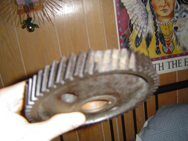

I had one that made the noise particularly loud. One day I changed the oil and had actually commented on how quiet the duke was then running. I didn't make it to work that day...
D'OH!
I took the "Pressed" on gear off with my bare hands, aparantly the keyway was VERY loose. This beat the gear to death.
This is why I'm going with the Quad 4 this time around.
