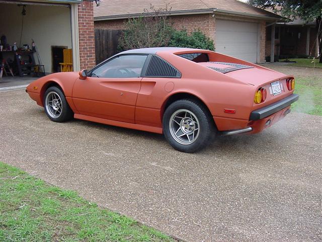

As it says... I would like your opinion on an idea I have. I did not set out to build a knock off of the Ferrari 308(I just like the body design), so I am thinking of changing a few things around. I am not pleased with the vents on the rear deck lid. If I happen to get caught in the rain, my whole engine will get soaked and cause who knows what kind of problems. Below is an attempt at trying to convey my image of what I would like to do. Instead of having the grill work, I would mold functional scoops over the openings, which would prevent water from entering my engine compartment. Please look at the pictures and tell me what you think. By the way the car is going to be painted black on black.
Thank you for your time .

i like it
go for it dood

I like them. Maybe just a little taller than you have pictured, or perhaps a little longer to the back, but I like them a lot.

I like it, and more functional. Good job with photoshop, that car will look killer in black.

Ya that photoshopped one looks much nicer than the regular vents. I know you wanted to put the scoops at the sides in place of the vents, but wonder if it'd look nice just one scoop in the middle like Tina's.

I like it as well. The scoops look sleeker than the grilles.

Look sweet! Give them a try. Don't forget the pics when you're done. I agree with Jstricker, maybe a little longer or beveled towards the front of the car.

Thanks guys.. I used Corel Photo Paint to do it(I haven't learned PhotoShop yet), and everyone of you were right. I do want them a bit taller, and little further back. Maybe with about an inch up before the opening actually occurs. If you notice the grill and the way it is shaped, I thought it would be neat to put a third brake light in the middle. Ponitac Boi, I had thought about a single scoop, but I don't think it would flow as good with the body lines.
If I could PS worth a crap, I would try to convey the idea I have for the side louvers. Instead of the louvers I was thinking some scoops there also. Sort of like scoops on a GT40, but not as protruding, and following the flow of the car.
As soon as I get her back from the upholstery shop I am going to get some foam and start shaping some scoops to see how it would actually look. I will take plenty of photos and do a post out here with the progress.

Third brake light......................nah, put it in the rear window kind of like the factory did it. I think if you try to blend it in there it's going to lose some of it's sex appeal. Bulges running fore and aft on the car = POWER to the mind's eye.
"Maybe with about an inch up before the opening actually occurs. " Bigger Bulge = MORE POWER! (Up to a point, you can go to far pretty easily)
I still really like it. Make your changes subtle enough that nobody can figure out exactly what you did but bold enough that they all come up and ask exactly what you did.

Granted that it's 0630, but after taking a quick look at the rear decklid < original > , and looking at the new scoops, I thought that you already had it available, and had just installed it onto the car asking for opinions!

I'm not crazy about it personally. I removed the lower baffles on the vents of my GT and have never had a problem. But then again, those vents were not directly over the engine so I can see your concerns. On my Indy, after a rain, the engine "steams" for a couple of minutes. Have you considered water baffles underneath as an option?

I like the look,
but a little concerned about the heat not being able to escape.

Those vents + a pair of 5-6" fans would be awesome. I vote yay.

Fans would be good, and I also have about a 1 1/2" gap between the hood and rear window. I figure the openings on the scoops would be at least 8-10" across on each side, and at least 2-3" wide for the opening.

Just use the Fiero Stores deck vent. Cut it in-half and mold a side piece for each opposite side. Copy the original side scoops that you have, and try to shape to look all the same and also elongate the tips to copy the body lines where the roof top slopes down towards the rear clip.
This is what I had done to my car, but I use the Firebird vent incerts.

I like the vents but I also think it's a good idea to keep the engine dry. How about a compromise? There are vents from a 3rd generation Camero Iroc that look pretty good.
I'm not sure, but I think they may be flat enough to bond onto the top of the scoops. That would give you the look of the vents and the function of the vents. Just an idea.

I removed the underside of the vents on my coupe and I can tell you what happens in a heavy rain...your belt will start slipping and you will lose power. I am going back to standard vents, I don't like the look of the open vents anyway.

Report this Post03-07-2004 07:52 AM Click Here to See the Profile for LZeitgeistSend a Private Message to LZeitgeistDirect Link to This Post
Actually, are those gonna be able to get rid of enough heat from the engine compartment? I mean, they look GREAT, but it's all gonna be for naught if your engine overheats... I'd personally rather have a wet engine than a seized one.
And as far as these 'vents' go, , I believe they weren't actually vents, but molded plastic inserts that just resembled vents... no openings. (I could be remembering incorrectly, though.)

Report this Post03-07-2004 09:56 AM Click Here to See the Profile for YellowArteroSend a Private Message to YellowArteroDirect Link to This Post
LZeitgeist:
I ment that the fake louvers could be bonded on top of the open scoops. The cooling would come from the scoops and the fake louvers give more of the original louvered style look.
Harold:
Nobody could remember the last one. For my new thread about the 3.4TDC swap, I decided to change.

Report this Post03-07-2004 10:26 AM Click Here to See the Profile for WholfSend a Private Message to WholfDirect Link to This Post
Originally posted by YellowArtero:
LZeitgeist:
Harold:
LZeitgeist, I know that there is a lot of heat put out by the 3800SC under the hood. But there is also quite a bit of room between the engine and the top of the deck lid. I would hope with the opening between the rear of the deck lid, and with the scoop openings, that there would be enough breathing room. Once I get it back from the shop I am really going to have to look at it closely.
John, I knew what you meant about using the louvers. The only problem is I don't have a whole lot of rear window as it is(you know what I am talking about). So any additional height would have to be used as operational room only. I could also put some vents/openings on the outside edge of the scoops. That should be more then adequate for venting heat.

Report this Post03-07-2004 11:43 AM Click Here to See the Profile for FieroHarrySend a Private Message to FieroHarryDirect Link to This Post
I like the reversed scoops, definatly use the fans to help move the air like Tina said!

Report this Post03-07-2004 12:35 PM Click Here to See the Profile for YellowArteroSend a Private Message to YellowArteroDirect Link to This Post
Just a silly question (maybe) ... but will scoops actually increase the air flow or stop it? I was playing around with the flows of vents and scoops. I attached some paper strips to the vents of my old '84. They indicated that the air flow was coming up through the vents at idle. When driving, the paper was sucked in indicating that the air flow underneath was sucking air down through the vents to cool the engine compartment. Reverse scoops use backpressure to force air into the engine. This effect changes depending on the location of the scoop to the windshield. With our cars, the design of the back end changes the flow of air. Question ... will the turbulence at the back of the car (and the shape of the scoop) create a negative pressure zone and try to pull air out the top of the engine compartment while the air flow underneath is trying to pull it out the bottom? Wouldn't that cause a cancelling of the flow and actually increase the engine temperature? I know when I played around with the vents and scoops on the Artero (they have a lot) more air flow wasn't really an advantage. I believe I had two different forces acting on the air flow. I'm not an expert but it is something to think about.
Wholf
Posts: 379
From: Cleburne, Texas
Report this Post03-07-2004 12:56 PM Click Here to See the Profile for WholfSend a Private Message to WholfDirect Link to This Post
John,
If the test you did showed air venting out of the scoops at idle, then that is what I am looking for. I am sure everyone here relizes that when you are stuck in traffic at idle, is when you have the most concern about heat building up in the engine compartment. I am figuring the cooling system and just going down the road will take care of everything else. I am also thinking about doing something to my side louvers that would make them functional(more scoops). They vent straight into the engine compartment, and if I opened these up, they should lay all concerns to rest. There was also the mention of mounting fans under the scoops to force air out, which is very possible with the room I have.

Report this Post03-07-2004 01:04 PM Click Here to See the Profile for revinSend a Private Message to revinDirect Link to This Post
Wholf,
I am using 6 small computer fans ( controled by toggle switch) that I placed inside my "stang" scoop on the rear. Works very well, yet nobody knows there are there
See ya in San Antonio!!
Oh and is that smoke coming from the car!!!! ha ha

Wholf
Posts: 379
Report this Post03-07-2004 07:57 PM Click Here to See the Profile for WholfSend a Private Message to WholfDirect Link to This Post
Nope... As you know, it will actually get cold sometimes here in Texas. I think It was like 34 degrees when I rolled her out of the garage that day to take the picture.
Still hopeing for the SA round up, but she will still be primer colored............

Report this Post03-07-2004 11:59 PM Click Here to See the Profile for TinaSend a Private Message to TinaDirect Link to This Post
Just a little food for thought.
I have been contemplating something simular,
the hurdle for me with this is, venting unfiltered (dirty) air into the engine compartment. (So, ..I am a clean freak)
Yes you could somehow manage to get a filter to cover the area of the side scoops where the air enters,
but how much would said filter reduce the air flow?
