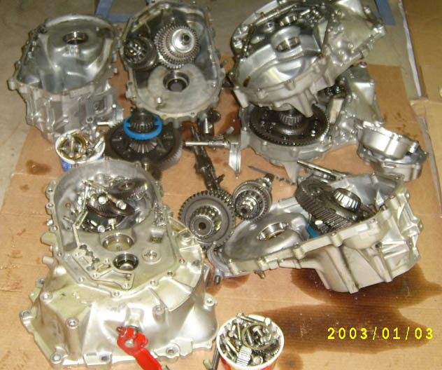

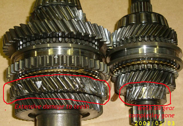

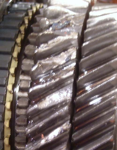

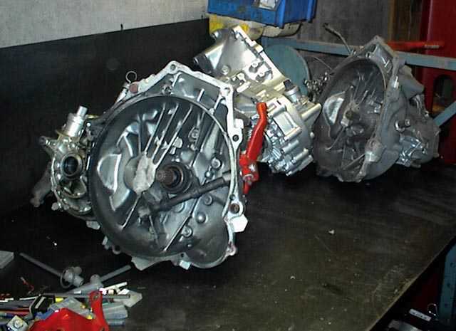

Meet the candidates ...
3 5 speed Izusu, varying vintage, one known to come out of a Fiero,the other ones were found in junkyards.

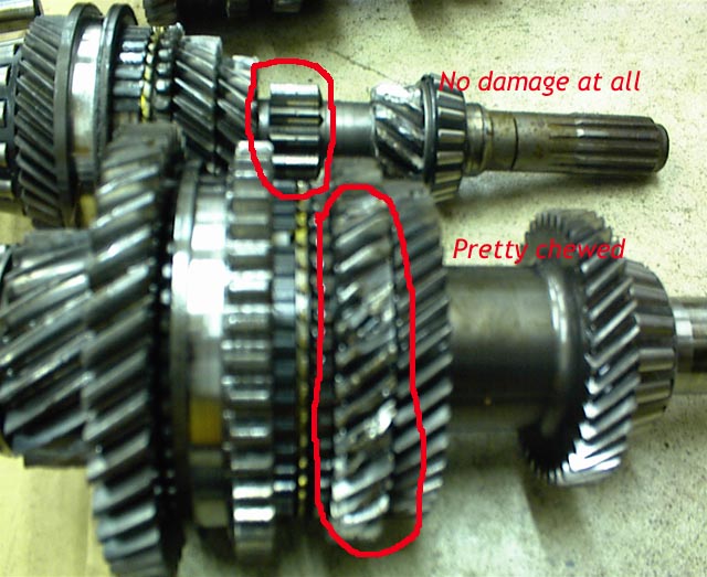

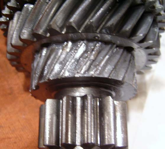

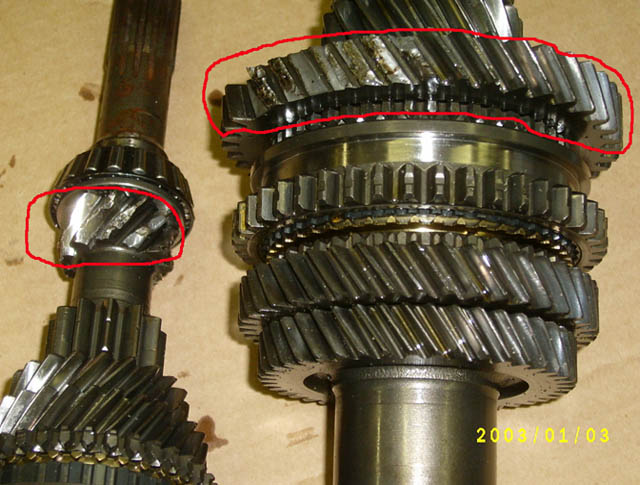

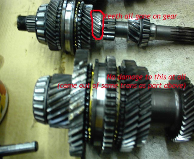

A few hours/metal splinters later ...
Damage was limited to the gears.
Differentials showed no damage in all 3
Spider gears no wear
Synchros well as well
More to come ...

All these seen time next to my 383 this past summer,
and kept for just this occasion.
To be taken apart and inpected for damage.
Only one more left to be taken apart ...a 98 cavalier Izusu
This one is going to be interesting too ...

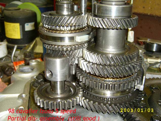

Report this Post01-04-2004 09:51 PM Click Here to See the Profile for TinaSend a Private Message to TinaDirect Link to This Post
Tina
2858 posts
Member since Nov 2000
Tina
TaurusThug
Posts: 4271
From: Simpsonville, SC
Total ratings: 102
Report this Post01-04-2004 10:01 PM Click Here to See the Profile for TaurusThugSend a Private Message to TaurusThugDirect Link to This Post

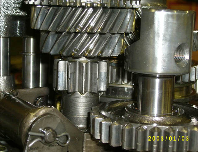

that last one looks like it is brand new (i have never seen a open tranny like that open so i am kinda clueless)
Tina
Posts: 2858
From: At an elevation of 8564 feet.
Total ratings: 119
Report this Post01-04-2004 10:14 PM Click Here to See the Profile for TinaSend a Private Message to TinaDirect Link to This Post
Better clarify ...
Last 2 picks posted are from the same 98 Izusu.
This trans was just removed from the car, still worked,
but I was rather curious what damage the trans actually had incured on our recent trip
to the drag strip.
(Some 12 runs, numerous high RPM clutch dumps)
But since it was a still usuable trans I didn't wanna totally tear it apart.
That's why it looks a bit different

Tina,
I've never been inside a transmission. Which are the damaged gears? 1st, 2nd, 3rd, 4th?
Which parts will be cryogenically treated?
Larry S.

Report this Post01-05-2004 01:07 PM Click Here to See the Profile for Fiero STSSend a Private Message to Fiero STSDirect Link to This Post
Look for the input shaft. The smallest gear will be first the largest will be fifth. Just the opposite on the output shaft. The straight gear is reverse. The input has to turn more time in first, like four to one to turn the wheels, than fifth, which it turns close to one to one.

Report this Post01-05-2004 02:01 PM Click Here to See the Profile for TugboatSend a Private Message to TugboatDirect Link to This Post
That just means it carries less torque than the output shaft.

Glad someone is keeping track of my "usuage"
Looks like Tim/STS came to the rescue on the 1st Q
Thanks Tim
If things go the right way, everything will be treated.
