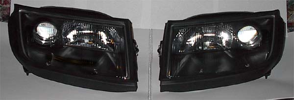

I wish you the best of luck... all i can say is... mounting is everything... find the perfect way to mount them, your set, but think long and hard about where you position them
these are the lights for those wondering

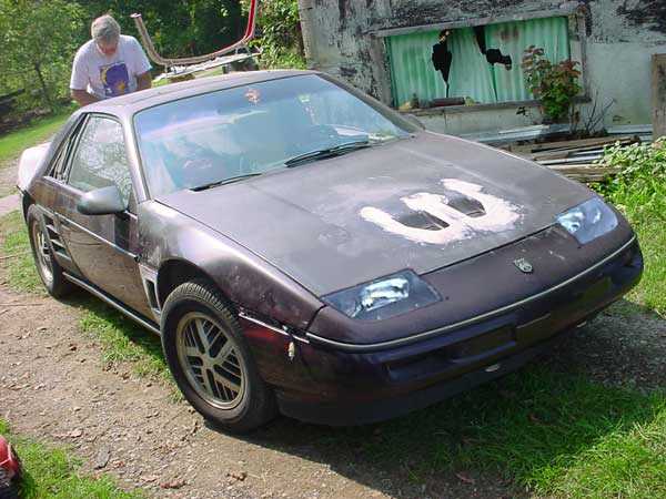

and these are ones actually on a fiero
