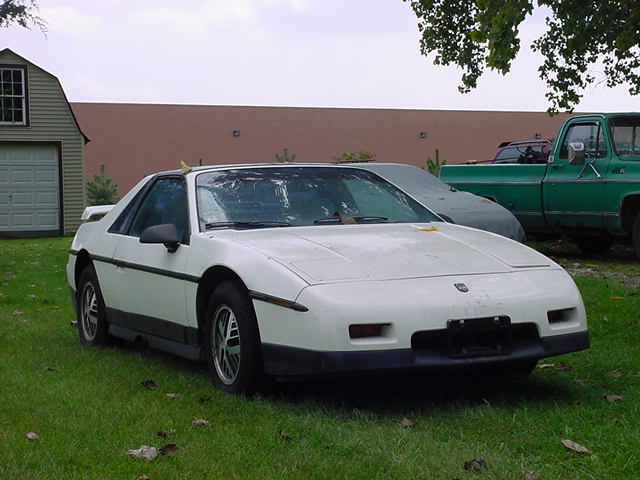

Here is the early nose 84 thru 86 coupe.

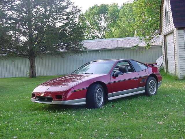

The 86 thru 88 GT Aero nose.

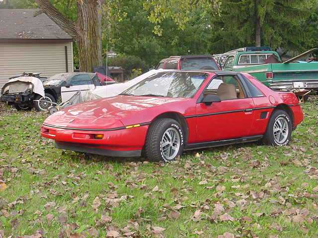

The 87 & 88 coupe/Formula nose.

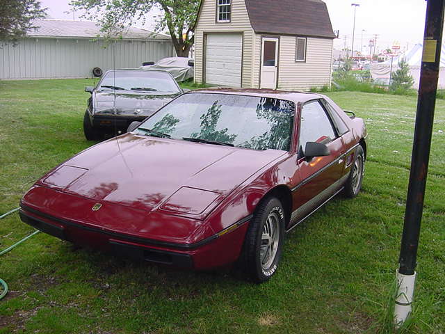

The 84 Indy, 85GT and 86 & 87 SE nose.
