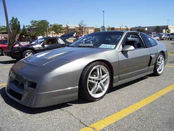

Not mine, but something I'm doing to my car.
now that is sexy...
Anybody have more pictures of this car? I would love to see them.

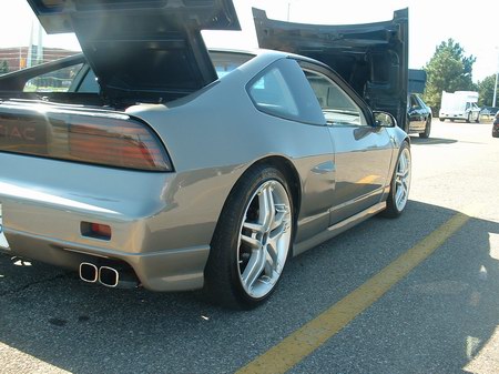

here ya go skitime
I second that, he even molded the bumper in with the rest of the body, this is something I was hoping to start with my car next year.
*EDIT: pics were posted just as I posted this, thanks liltobe! :d

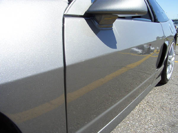

easy to shave the handles. Fill in the indent where your hand goes, Then get some extra pieces of door trim from a parts fiero. Cut the extra pieces to fit in the space where the actual door handle was, then bond it in the gap where the handle is with like an expoxy. Sand any of the expoxy that seaped out down so its smooth with the rest of the side trim, then spray black to conceal the modification. Nobody will ever know the handle was there. I believe this is the method Archie used on the stinger
as for that smoothed car... i can honestly say i dont really like it. The coops look funky on it now and the crease like where the trim was it kind of weird especially on the nose
Actually, Archie cut out the door handle section of the door panel. He grafted a section out of another door panel. Then he took two pieces of moulding and fiberglassed them together. Beautiful job, IMO.
