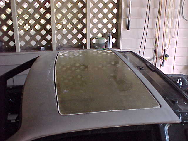

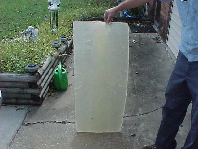

I can/have made a fiberglass insert for a sunroof that can be used as a solid sunroof or to make your sunroof into a hardtop if you do not want the sunroof option anymore. They are light and super strong,carbon fiber ones will not net any wieght savings over a fiberglass one. A plus is it can be molded into the original roof like I originally planned it for to make a hardtop. I can have one produced a day. They would be trimmmed and pretty much ready to final sand and prime.
Price would be somewheres from 75-100, haven't gotten a total materials list together.

Thats pretty cool, i imagine it could be used as a replacement for the glass itself
86 FIERO GT
Posts: 1134
From: Louisiana
Report this Post11-21-2003 02:01 PM Click Here to See the Profile for 86 FIERO GTSend a Private Message to 86 FIERO GTDirect Link to This Post
Yes after we got it trimmed, we noticed it would be a perfect replacement for the glass if you wanted to block sun or make it look like a hartop without findin one or making it permanent.

I would need a pair of bad but not broken or cracked T-tops to work with. The top of the peiced that sat on the glass is smooth like the glass so I see no need for a gelcoat. I am thinkin about roof scoops too at this point. As of now I don't see enough interest.
edited for Howard, ya you might be able to go lighter with C/F but how much 5-6 ounces?
